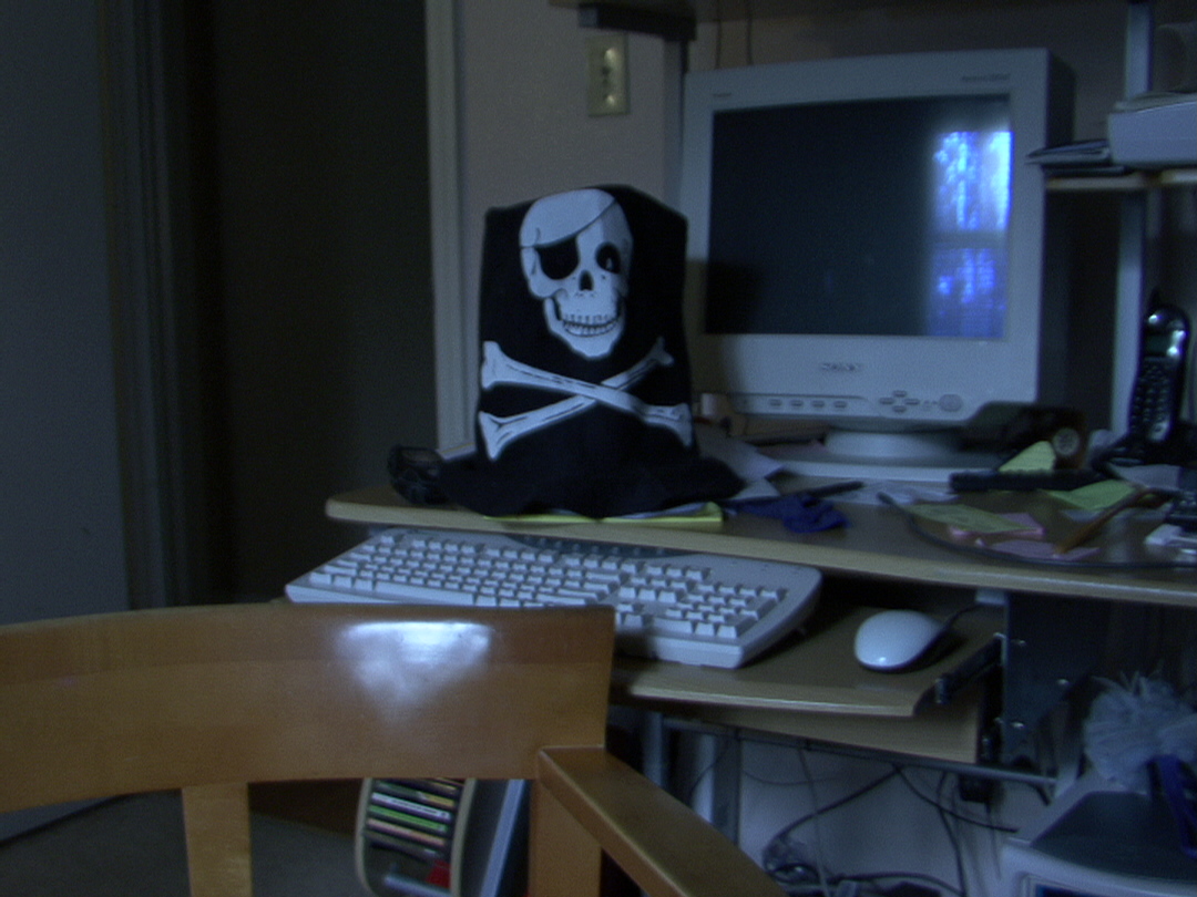

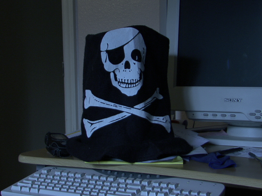

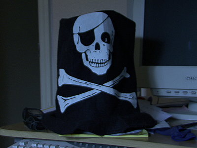

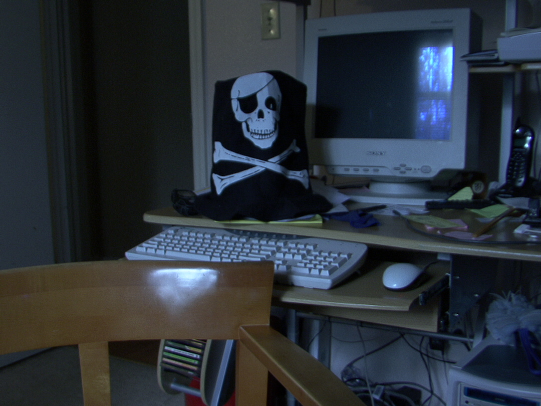

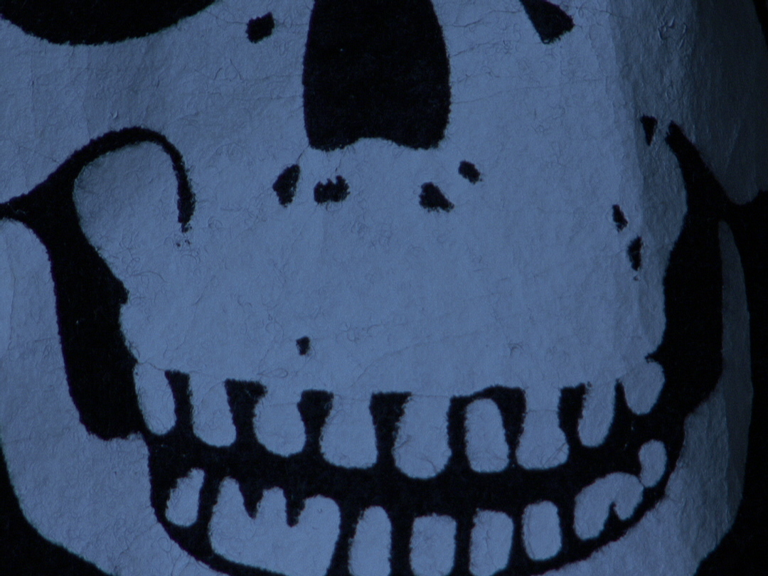

Once again the back focus does not seem to work properly on my V1U. In manual focus mode I should be able to zoom in on a static object, focus and stay in focus from telephoto to wide. As shown in the attached stills you can see I've focused sharply on the hat in the first image, however the image goes soft when zooming out to frame and then to wide in the second and third images. In the the last two focus is restored by racking the focus ring to infinity. I had this camera in to Sony a few months ago for the same problem and was told it was due to engagement of the macro focus function. Macro focus is off on these images and by the way it makes no difference if it's off or on. I guess it's back to Sony again. I hope I have better turnaround than Ralph :( BTW, select each image to see the full resolution version.

Thanks for your input, but I believe you are referring to auto focus which in my opinion works great. My issue is with manual focus. At any focal length I can manually adjust the focus (usually to infinity) and get a reasonably sharp picture (as evidenced in my photos). On a static subject (such as in an interview) I should not have to readjust focus after zooming in fully and setting the focus. As long as the subject doesn't move toward or away from camera focus should be maintained throughout the zoom range. Even more so as the 1/4" CMOS imagers have a deep depth of field even at wide aperture.
"Back focus" refers to the focus distance from the rear lens element to the focal plane. On professional camcorders with interchangeable lenses, there is a user adjustment for this issue on rear of the lens. On fixed lens cameras it is a service issue.
