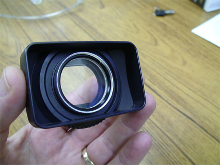

FYI, the HC1 lens hood, when attached to the camera normally allows the attachment inside the hood, of a 37mm screw in filter.

I am currently bidding on a used HC1 on ebay, so the more I know about the camera the better. I've read that one has to do the "tabectomy" to ensure that a screw-in filter works with the stock hood. Unless you mean something like this:
http://www.dvinfo.net/gallery/files/...8/Screw-on.jpg
I saw an HC1 on ebay with non-stock and non-A1U hood. Maybe it was large PDX10 hood? I don't know.
That is exactly how a filter is installed.
