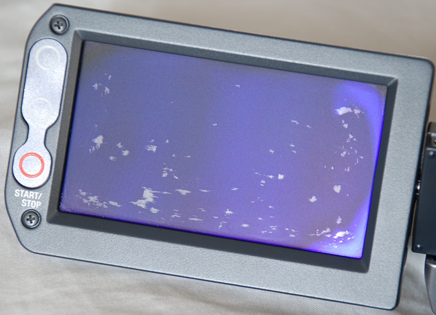

My HC7's LCD has been developing blotches since 1 1/2 weeks ago, now the screen's got 15% blotches, 85% untouched. When you look closer, the blotch actually looks like chipped glass. I was afraid that it might be the nails scratching the LCD screen or something. This is very annoying when I shoot in bright sunlight. So, what should I do? (exchanging and shipping it away to a non-local location is not an option, I'm going to China on July 13th.)
Please answer ASAP.

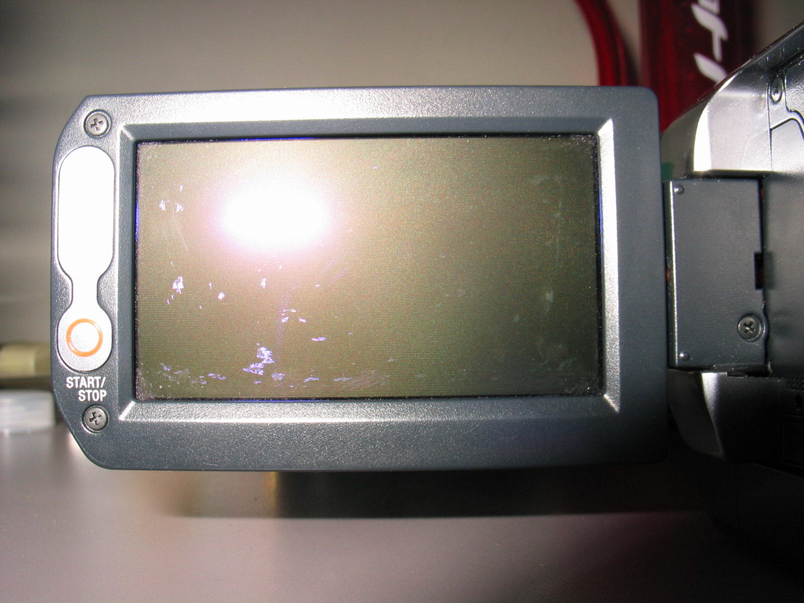

I can't tell if it's your picture or what, but my HC7 seems to have a much "shinier" screen - yours looks sort of semigloss, mine's actually almost a gloss... any chance there's a protective film on it? Got my cams used, so don't know if they put anything on the screen at the factory, but that's the only other thing I can think of...

Here's another picture taken under sunlight instead of flash.

All I can say is that screen looks very different from mine - I'll try to snap off a picture tomorrow and post... You might want to at least report it to Sony or whoever you bought it from so it's been noted and you can get it fixed - owned several touch screen cams, and none looked like yours...

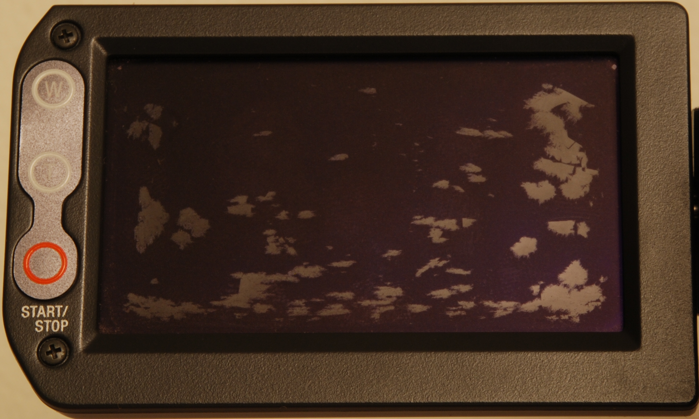

Update: It's gotten worse! The blotch size has increased, and for a moment, the touch panel malfunctioned! It kept trying to point at one spot whenever I turn on the camera.
I think it's fine now (the touch panel) and it might've been due to a static charge but I'm not sure so I need to send it in for repair and to possibly find out what's wrong with the LCD. The camera can still record though.
Attached is an updated picture of the blotched LCD. (very high resolution)
Hopefully I'll get it fixed tomorrow.

Looked at the two pix you've posted, and observe that the problem areas are in the same spots, just enlarged in the second pic, so it's not just dirt/surface... you may have a bad LCD - I'd begin to suspect that one or more of the layers that go into making the actual panel is missing or defective (unless of course there's a protective film that sure doesn't look to be there <wink>). It looks to me like a de-lamination or contamination between two layers of the panel.
I've deconstructed a couple of these LCD panels on defunct digital cameras (no touchscreen) just for amusement and education - they have LOTS of layers, and anything gets in there, and you can get blotches... usually though the blotches would be more indistinct - yours are very well defined and growing...
I'd take it in, and take printouts of the two photos so you can show that the problem existed early on, and is getting worse - that should substantiate the problem enough to get a diagnosis and get it fixed.
I don't know about your cleaning technique - I know some people have really toxic body chemistry that attacks some materials... but I doubt that's the source of your problem as the blotches are in the exact same spots... only bigger!
