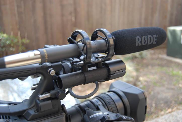

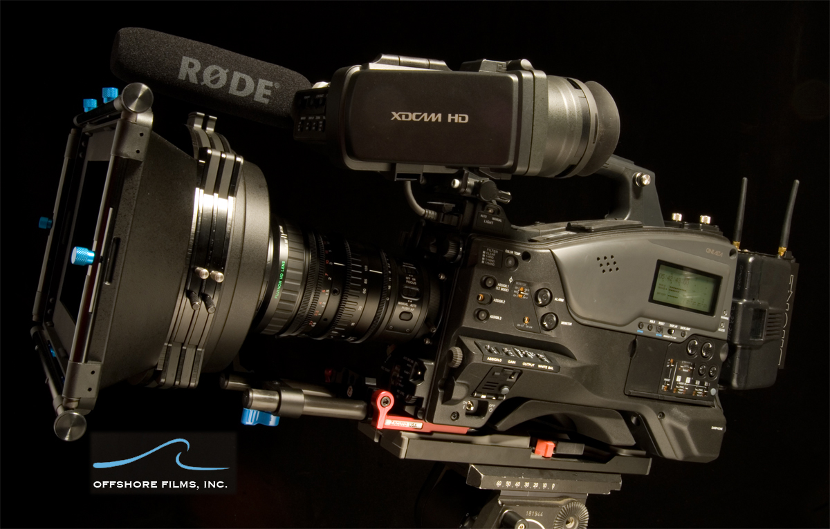

I too will not use gaffers tape rolled around a mic for it to fit the holder. I've got many foam windscreens from a multitude of obsolete shotgun mics. I simply snipped an inch off one of them; slipped it onto the new mic, and mounted in the mic holder. Seems to work fine without having to resort to tape.
However, I decided to try using the Rode Shockmount 5 (ROSM5); about 50 bucks from B&H. I have not field tested this on a job yet, and it will probably turn out to be
a pain to deal with as the mic won't fit in my PortaBrace bag without some disassembly. Possibly over the top and too much crap on the camera.
