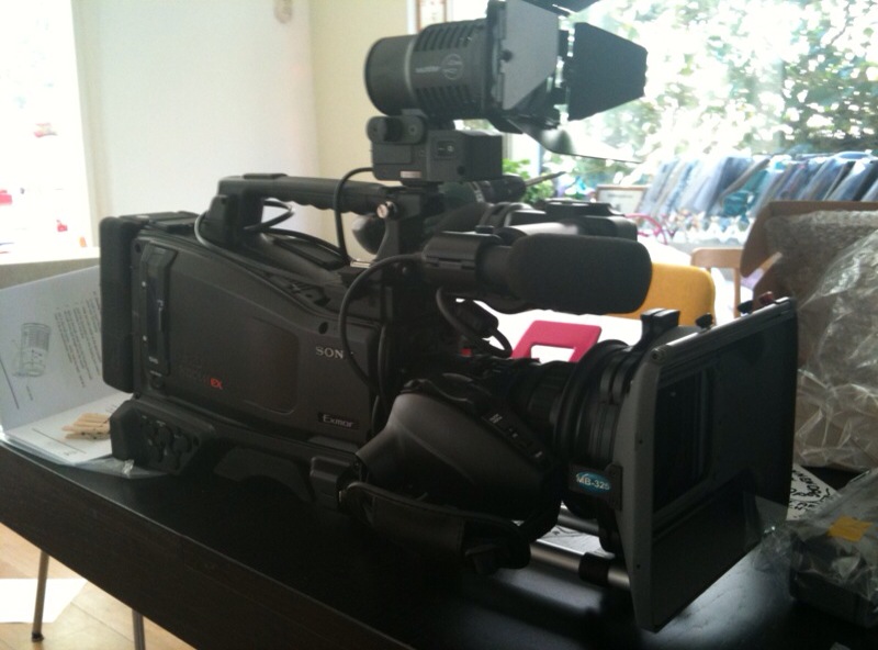

I received 2 PMW 350's today (very exited!!), and had it order with 2 vocas mattebox systems inc. rod support. Connects perfectly with the stock lens. See this iPhone pic:

I have a Cavision Matt Box and I would like to make use of it. How does the rod assembly attach to the camera base? Did it require the removal of the V wedge from the 350?

Yes, 4 screws to remove and re-use them to place the bars support. Easy as that..

The Vocas one (and I think all of them) works how Doug describes.
