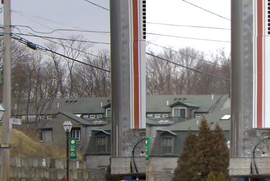

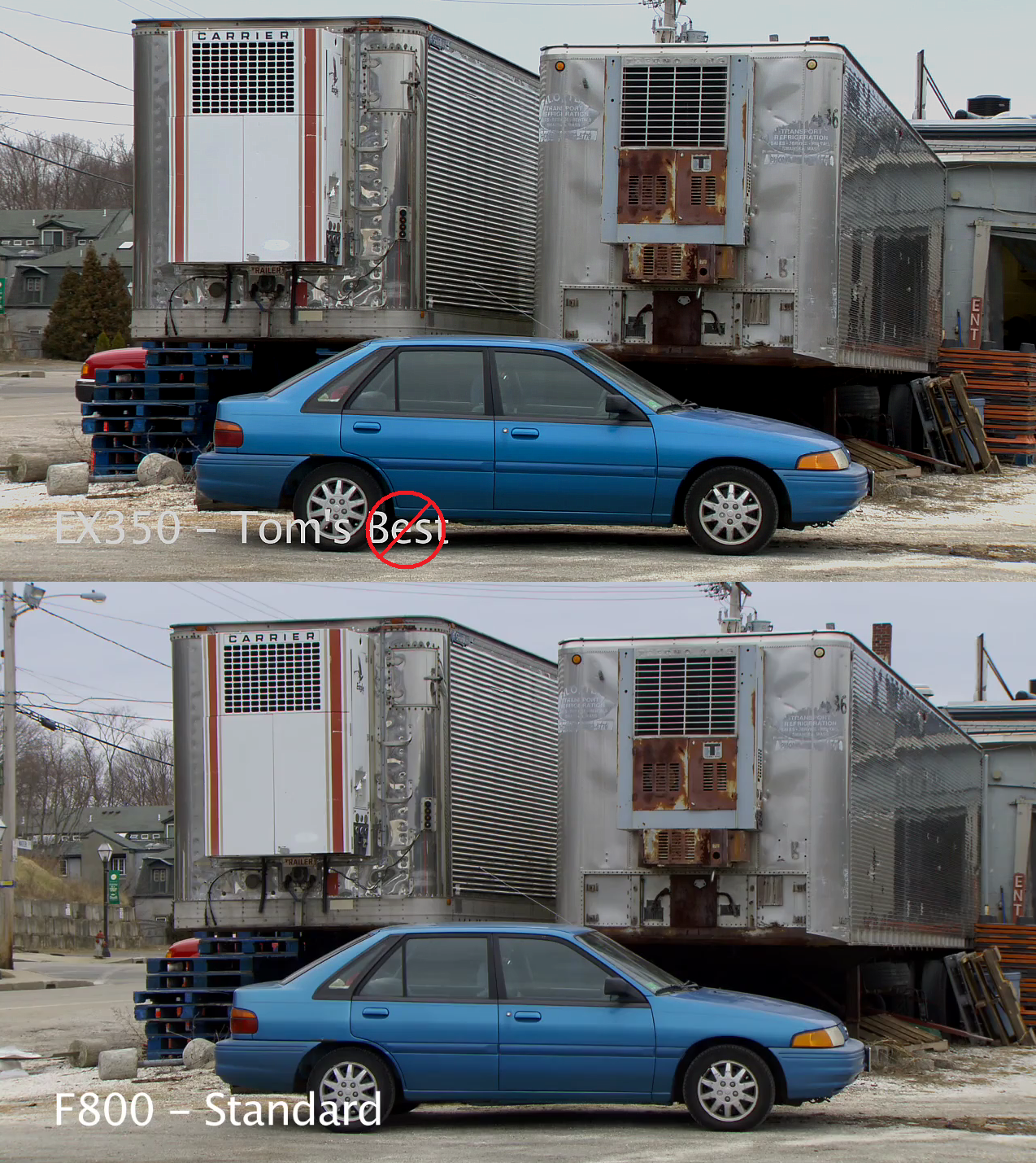

800 on the left, 350 on the right.
Paul, in regards to point #4. above, are you saying the softness in the corner is not dof? I have never seen f5.6 this soft. Something is wrong.
Edit:
Actually it should be softer because it's 720p not 1080p. I still think the image on the left is oversharpened, at least for my taste.

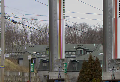

It's just processing
Same split image as before, 800 on the left, 350 on the right. This time the 350 image was photoshopped to match the contrast, brightness, hue, and sharpness of the 800 image.
Pdw-700, pdw-800, pmw-350-crop.png   Pdw-700, pdw-800, pmw-350-comparisonadjusted.png

Tom there are multiple thing going on here.
1. The 350 was about 5-6 feet left of the 800 so what is framed in the top left is different subject. You can see the 350 has the tree and 800 does not.
2. Exposure is not exactly the same but both are within our f/8 - f/5.6 range that we discussed.
3. Vimo does not handle any of the clips well on the edges.
4. You can’t take a heavily compressed still pulled from a vimeo clip, put it in photoshop and have it mean anything to us.
Again 800 wins in OUR eyes! No problem that you disagree but you won’t change our minds.
Paul Cronin
www.paulcroninstudios.com

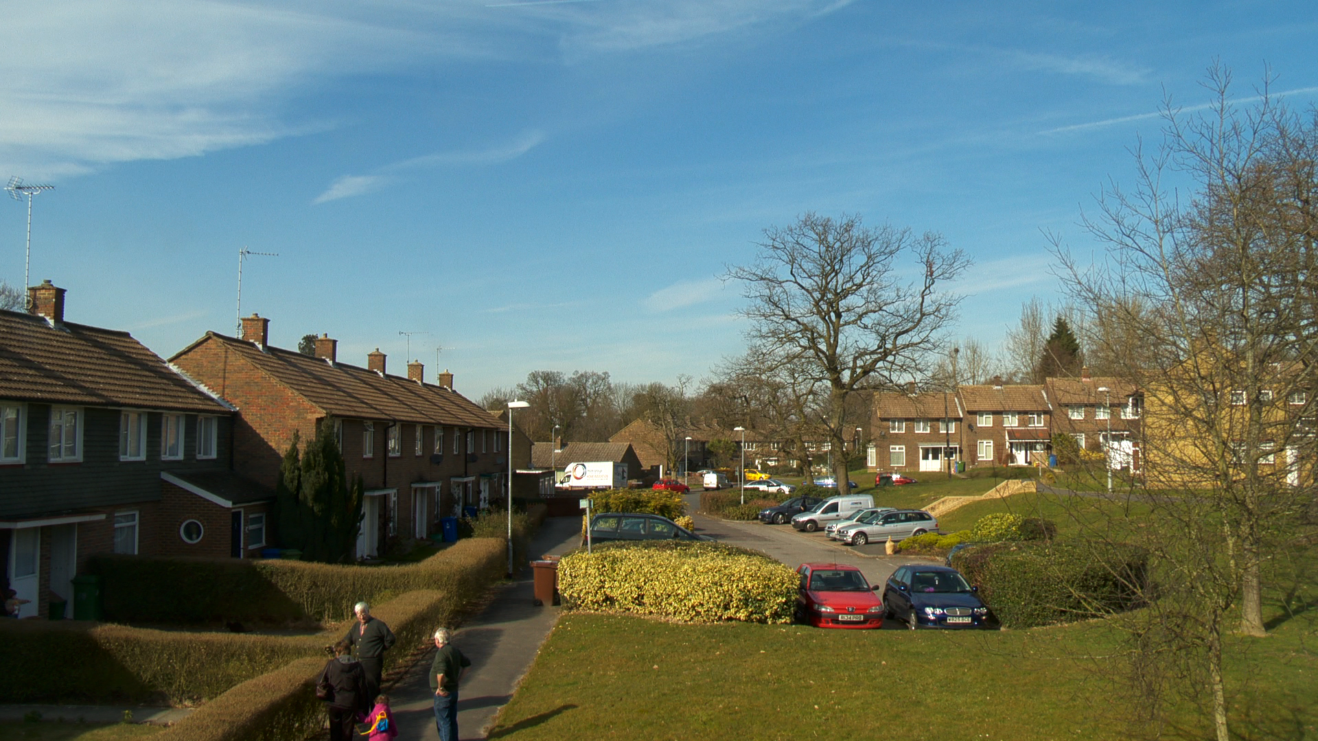

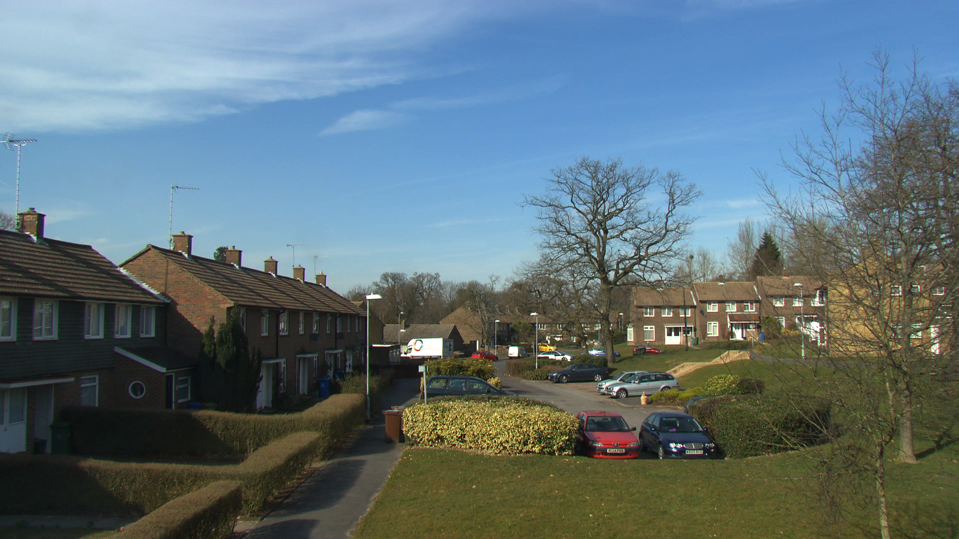

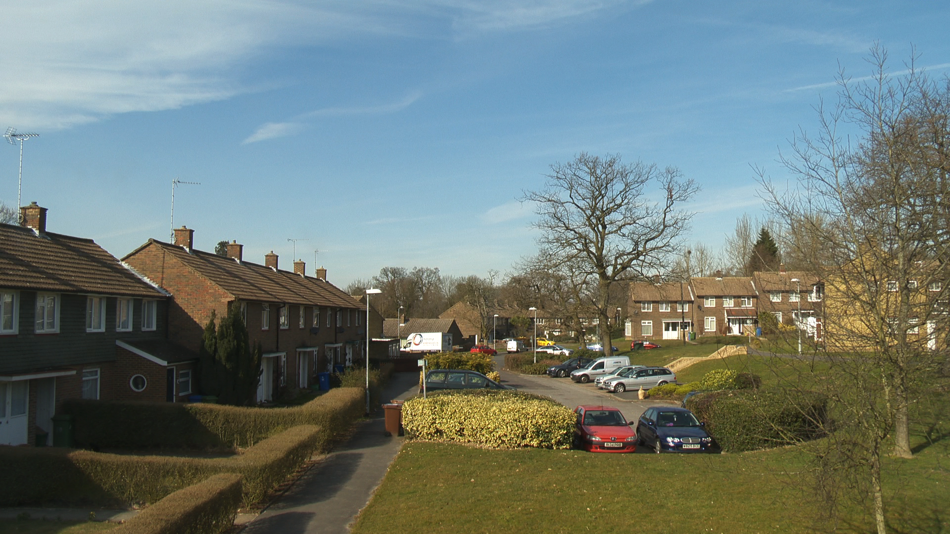

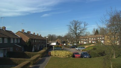

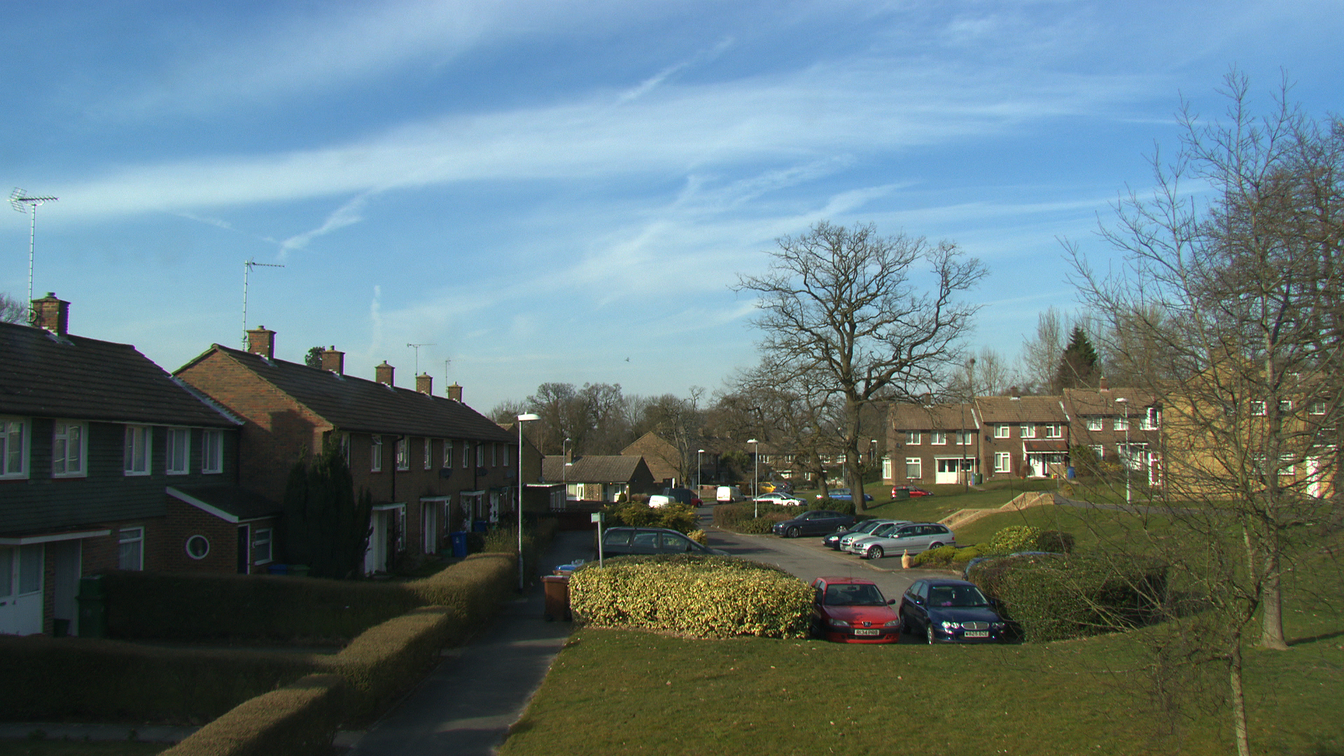

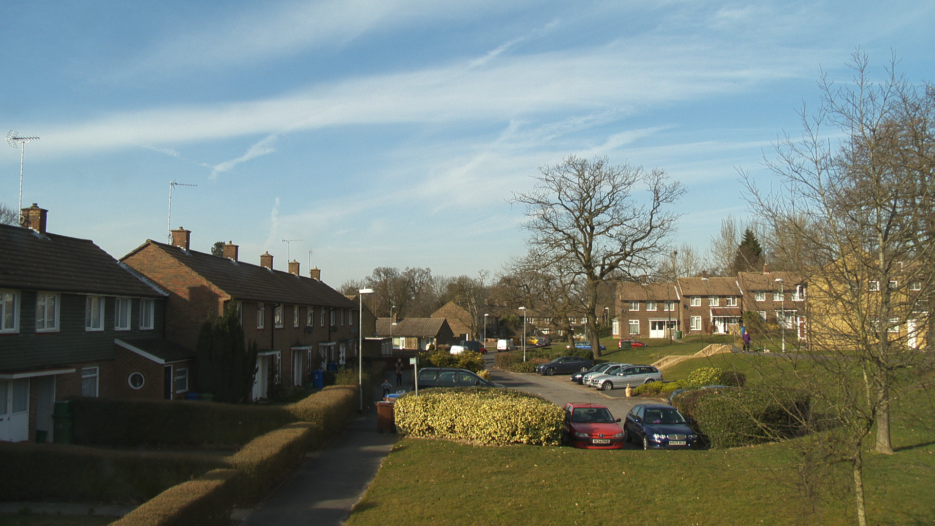

I had a few minutes today, a nice sunny day, to grab some further frame test shots and these I believe are quite telling, and perhaps give a good idea of the differences between the PMW-350 and PDW-700.
There are 4 grabs with standard settings (2 standard gamma, 2 Hypergamma 4), same lens on both cameras, both cameras set to 5600k white. Looking very closely at the pictures what I see is practically identical dynamic range. The white van in the distance is blown out on the PDW-700 standard gamma shot, but this is I think just slight differences in the knee, on the Hypergamma shots it appears about the same for both cameras.
What is interesting is the slightly better chroma clarity from the PDW-700, if you look at the distant red cars and the yellow bushes there is more clarity to the PD-700, but then this is to be expected as the 700 is 4:2:2 against the 350's 4:2:0.
So I chose to do one further test this time with both cameras recording on to a NanoFlash at 100Mb/s. These grabs are quite revealing as the chroma resolution is now much more evenly matched. If anything now I prefer the 350 as the specular highlights on the distant red car (behind green box) look better from the 350
So my conclusion is that the recordings from the camera are superior from the PDW-700, no surprise there, but add a NanoFlash and the difference between the cameras is tiny. You just have to be happy with CMOS over CCD.
Stop Press: Just as i was about to post this I noticed on the NanoFlash grabs that the 350 appears to be holding on to highlights better than the 700. Look at the white house doors on the distant houses and the white vans. I can see details of the door frames in the 350 shots that are lost on the 700.
