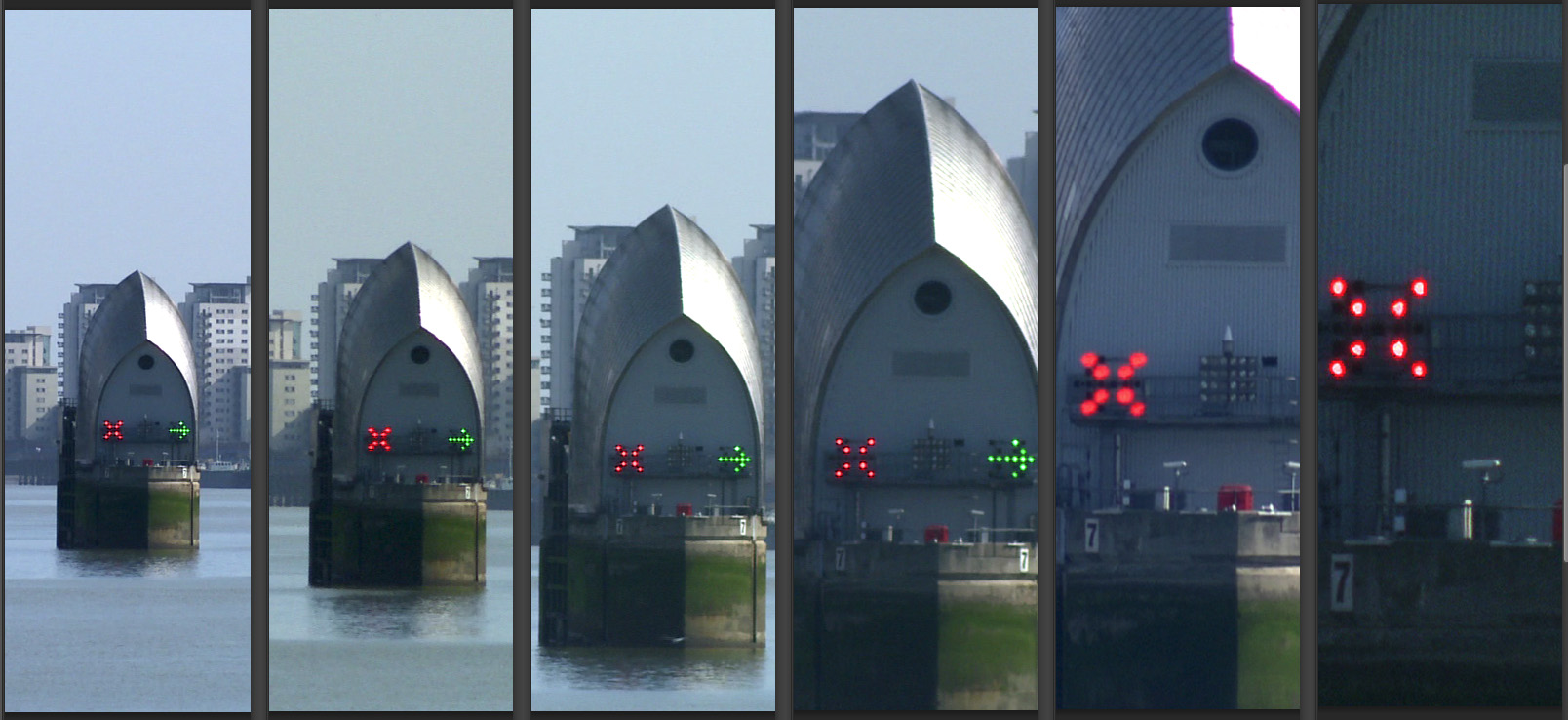

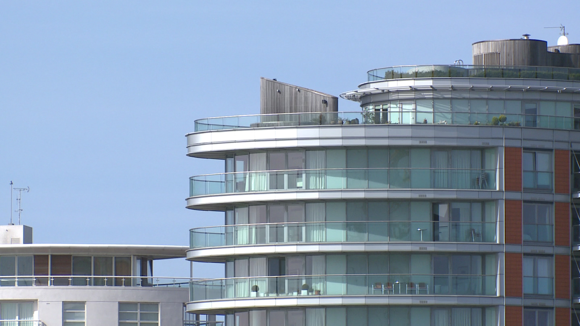

I was just looking at some comparison shots of the Stock lens and my Nikkor lenses. Here is a shot taken at Full zoom on the stock lens and the same shot with a 85mm f1.8 Nikkor lens, they both about the same focal length.. Notice how much C/A is present on the stock lens, partuclary at the right edge.
HD 2/3" Lens Tests-sonytelephoto.jpg   HD 2/3" Lens Tests-nikon-85mm.jpg

Here is a range shot 85, 105, 135, 200, 300 and 500mm Nikkor lenses I have also included the scene taken with the stock lens at wide and telephoto. The 300mm is perhaps the weak lens in the line up, it displays some flare which looks like C/A
HD 2/3" Lens Tests-lenses.jpg   HD 2/3" Lens Tests-sony-wide.jpg
HD 2/3" Lens Tests-sony-tele.jpg
