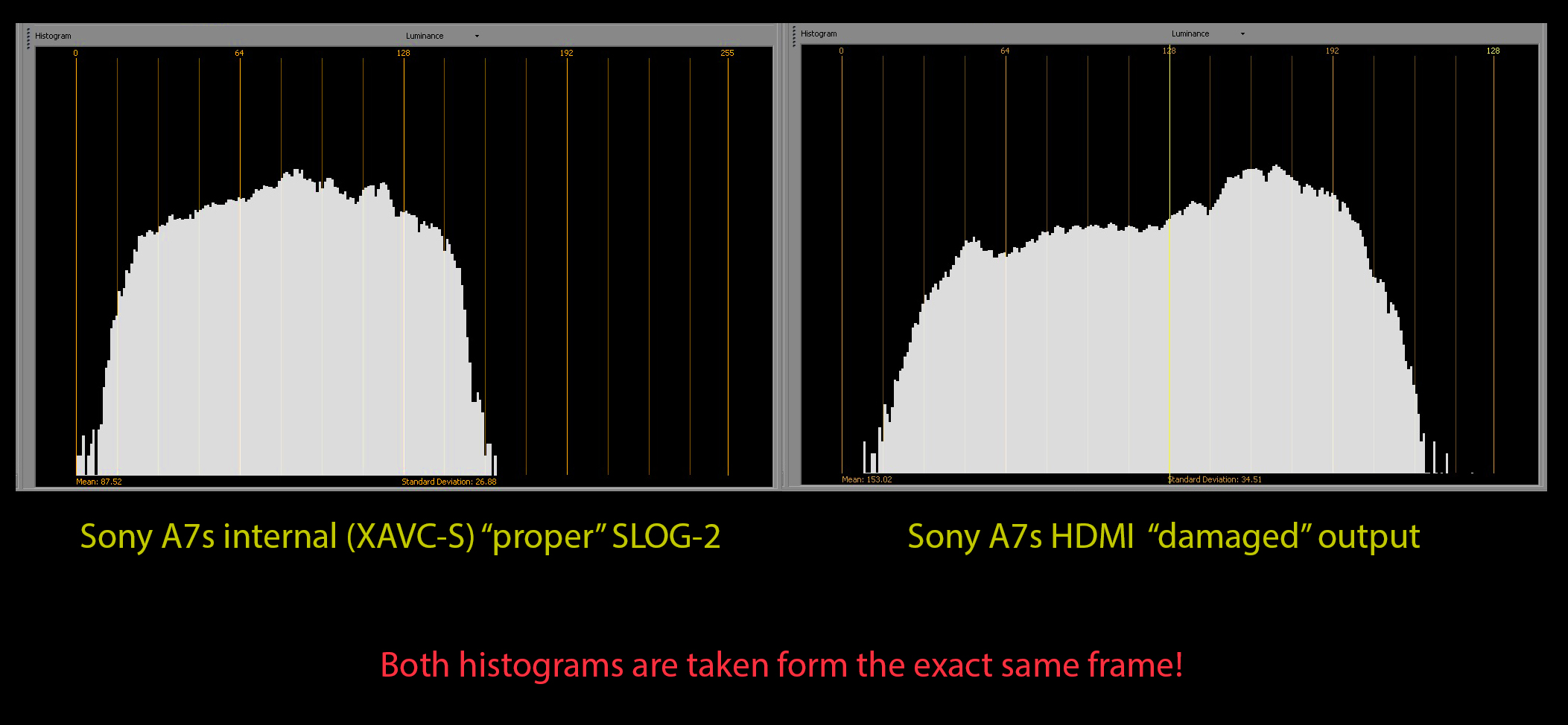

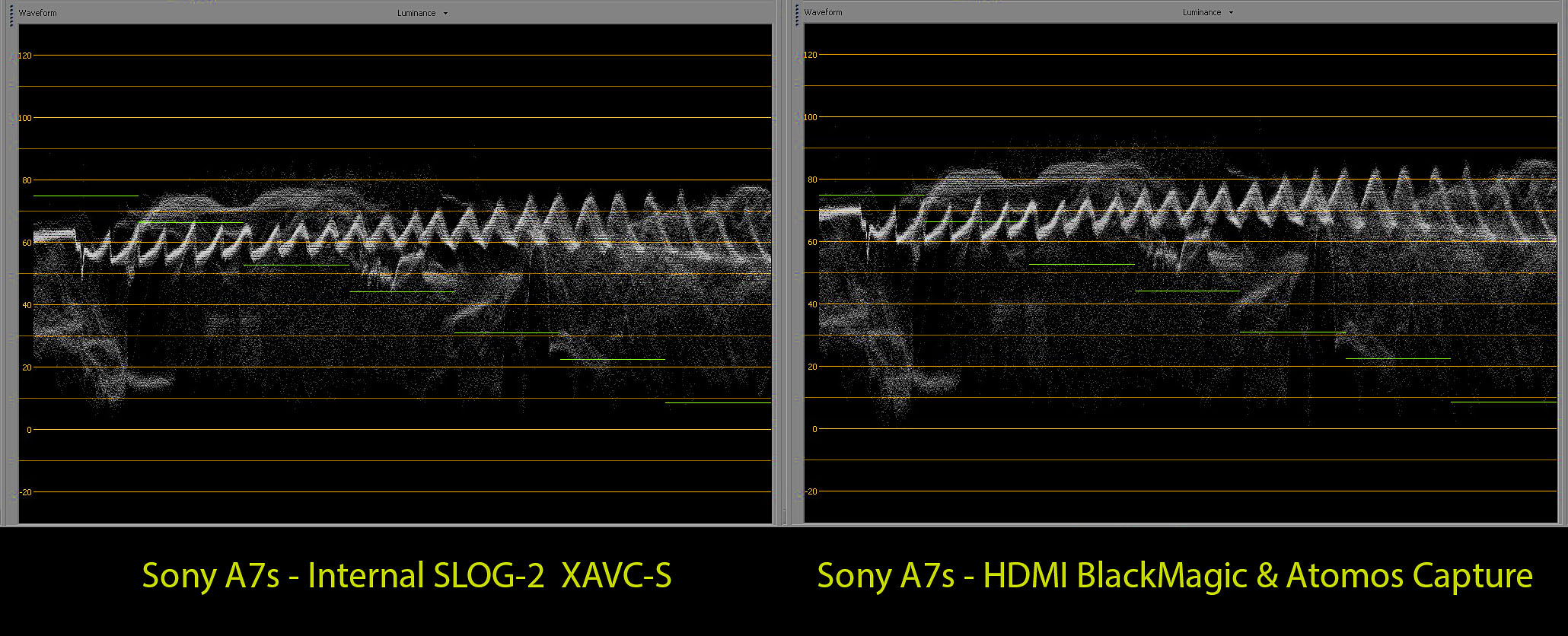

Did a test tonight between SLOG-2 recorded on XAVC-S internal vs. SLOG-2 recorded over HDMI.
Comparing both files on wave form scopes show some big differences. The XAVC-S file, the SLOG-s is nice and flat. However, the HDMI recorded file has substantially more contrast. Highlights at 70 IRE on XAVC-S were spread further up the scale to 80 IRE. Shadows that registered 10 IRE internal were now spread down to 0 IRE on the HDMI port.
I'm hoping A7s owners will do their own tests to confirm this. It's a bad thing that I hope we can get resolved soon.

BlackMagic 60i HDMI capture....exactly the same problem. This is not an interlacing or pulldown problem.
Looking for more A7s testers with any HDMI recorder.
1.) Record a SLOG-2 internal XAVC-S file.
2.) Record via HDMI to any recorder that you have.
3.) Compare both files on a scope...you will see that the SLOG-2 gamma curve has been stretched and "damaged". (compared to internal file's "proper" curve on the scope)
Again, Convergent Design posted this problem not long ago on their thread.
CT
Check out the scopes. Everything above 20 IRE shifts (stretches) up...below 20 IRE shifts (stretches) down.
Edit: As you can see in the histogram, the SLOG-2 gamma log is certainly destroyed.

I rented an A7s a few weeks ago and can confirm the same issue recording to a PIX240i.

Dear Friends,
This issue can be easily shown without a video recorder.
Just connect an A7s (set to S-Log 2) to any HDMI television.
The image will not look like normal S-Log 2, it will not be "flat", there will be more contrast.
This is not a recorder issue.
Personally, I believe that this is not an attempt to cripple this camera.
Of course, we would like Sony to allow regular S-Log 2 to be output the HDMI port, when S-Log 2 is enabled in the menu.
