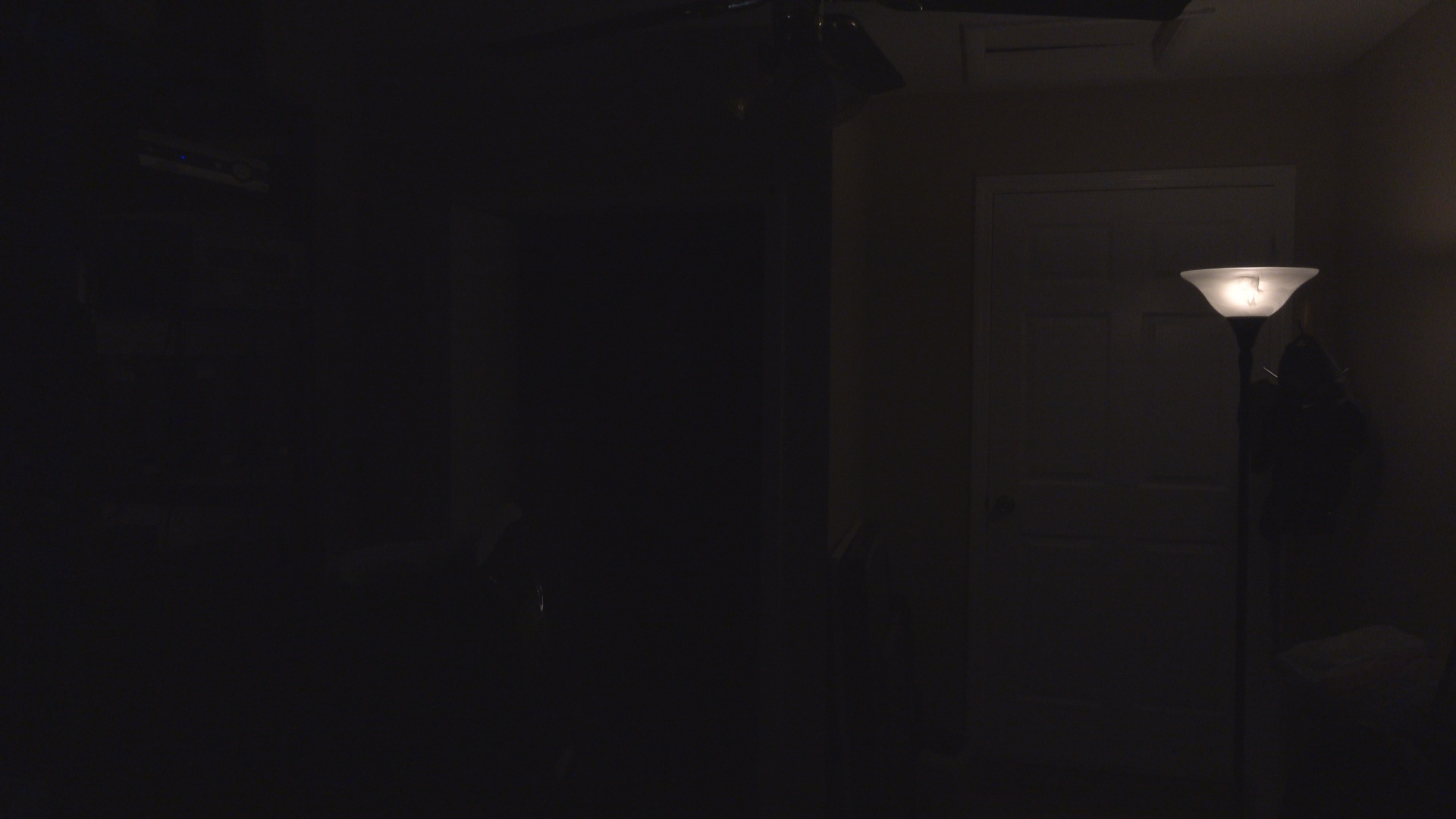

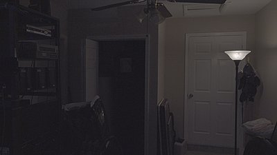

Here is a good SLOG-2 vs a "normal" REC.709 image (PP"off")...
The light to the right is exposed to about 100 IRE on both shots.
Look how much more latitude SLOG-2 gives. again, this is exactly why Sony developed SLOG-2. You can increase exposure without clipping the highlights.
I have this as two short videos files if you don't believe the frame grabs. ;-)

I doubt it. Sony would really need to add 100mbp first. SLOG needs to be stretched back out into rec.709. You need a durable codec to handle that.
