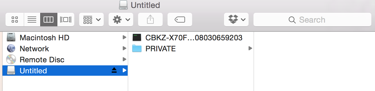

After spending the better part of the afternoon attempting to decipher Sony's sense of humor, I have lost mine. I gave up trying to navigate the ridiculous website (hadn't seen The post from Atticus), I emailed Sony a few days ago and they sent me a reply that claims to have my install code, upgrade file and instructions. the install key is a 30 kb Unix file that seems to do nothing, I do not see an upgrade file. I have copied this Unix file to the SD card but the camera tells me that there is no file. This routine has been performed about six times to no avail. Sony is way too busy to talk to me, they wil call me back.
I thought the 12 x 12 box that contained a 2x3 box, that contained two sheets of paper was a joke, seems it was just the beginning! I don't know if my email doesn't contain the upgrade file ad that's why it doesn't work, or what, but Sony is not telling, I know that.

When copying it down to your computer. Be careful not to change anything about the file. It's tint with no extension on it. Make sure that when you save it from the email that your browser doesn't put a (1) at the end of it. I saved it twice in my folder and Chrome gave the second one a modified file name.
Make sure the file is in the root of your SDXC card too. Not in another folder.
My upgrade file was 1kb....much much MUCH smaller than yours. My file literally contains 29 ASCII characters in it on a single line.
If your file is 30KB,...that's MUCH larger than mine.
Open your file with notepad....what do you see?

Sorry to hear about your experience. The upgrade key you are looking for is a file of 30 bytes -- not kB. Its name is something like
CBKZ-X70FXINSTALLKEY_20150707112345678
with no extension. That file needs to be copied to the root of your SD card with no modification at all, no filename extension, nothing. Then the SD card goes in slot A.
They will probably also send you a PDF file, which you should keep for your records, but it's otherwise not needed.
Hope that helps....

Thanks Guys! That is an accurate description of the file that they sent me. I formatted the A slot SD in my camera, copied the file from the email to the SD (it showed up above the "Private" folder, removed the SD, put it in the X70, went through the steps to the install, but it tells me that there's no file.
I thought it was pretty straight forward, but I'm obviously missing something.

Re: X70 4k Upgrade - The Install
And this on the SD:
Jim

Be absolutely sure that the purchase key and the camera unique device ID were entered correctly on the website install key request form.
It's been reported that if there is an error in the camera ID number, they will still send you an install key, but it simply won't work.

Thanks Robert. Maybe that's it. I went the Sony email route with the serial number and that was what they replied with. I'm probably stuck now, I would imagine that you get one bite at the apple.
