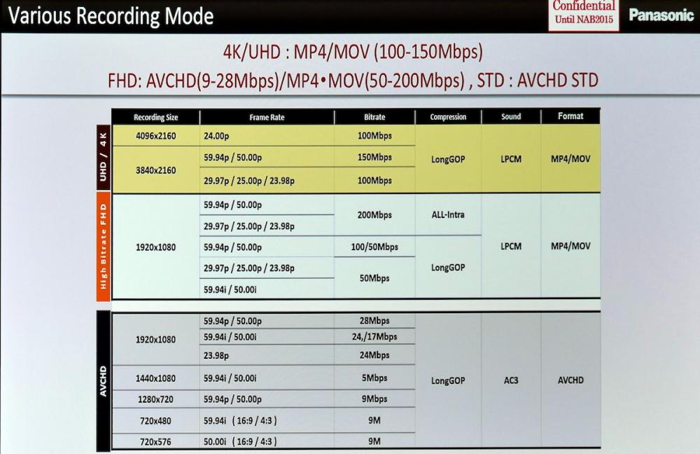

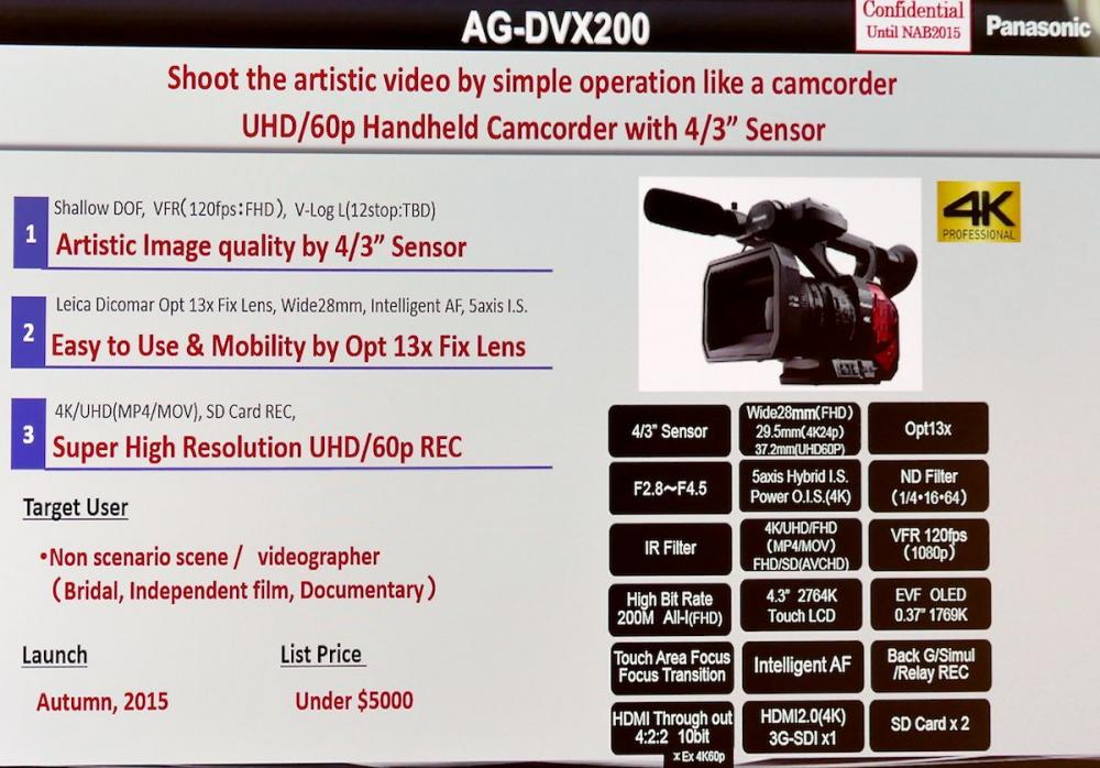

Generally agree with your statements but I notice though that there are some caveats that come with the Panasonic DVX200 in getting that higher bit rate and that is the windowing of its sensor in UHD.
In the DVX200 at 4K 24p its 28mm wide lens becomes 29.5 and that in 4K 50/60p it becomes 37.2mm! That means they are windowing the sensor by 32.8% to be able to output 50/60p in 4K at 150-mbit. That's a massive crop. With the fact that MFT has a crop factor of 2 x That's a wide end equivalent to 74.4mm in a full frame camera... not very wide in 4K at its widest is it? Even if you had .8 x zoom through wide angle converter that brings it it back to 59.52mm. A 60mm wide end in a fixed lens UHD camera, hmm, well that's a tough ask that one. That lens width wouldn't work for me.
What's also not great in my mind is that at 1280 x 720 in 50 / 60p Panasonic is stating a maximum bit rate of 9-mbit, yes you read correctly 9 -MBIT! With a highly compressed AC3 audio codec to boot. To me that's crazy as it makes the 720p video selection on the DVX200 a pretty useless feature. I don't know about a lot of you guys but I do most of my corporate web based work in 720 50p and 9-mbit just won’t cut it.
I wonder if the X70 will lose lens width in UHD? I don't think so having seen the 24p example here.
I've downloaded the 4K file and it looks pretty good for a cheap camera in spite of it being 60-mbit. As it stands I think the camera as a pure HD cam is well worth the money. If I want full 4K at a higher bit rate I might look elsewhere but at the moment it won't be the DVX200 on its crippled lens spec.
See attached DVX200 specs. Lens width specs under the picture of the camera.
The 28mm & 37.2mm focal lengths stated are already at the 35mm equivalents - ie. at 50/60p the FOV will be equivalent to 37.2mm on a full frame camera - not that wide but very useable in many situations.
If it is genuinely at an equivalent of 74.4mm that would be a joke & Panasonic would be laughed out of business & the only people would would buy this camera (with 800mm+ equiv. at the tele end) would be people who film birds in flight & peeping toms/perverts!!!
