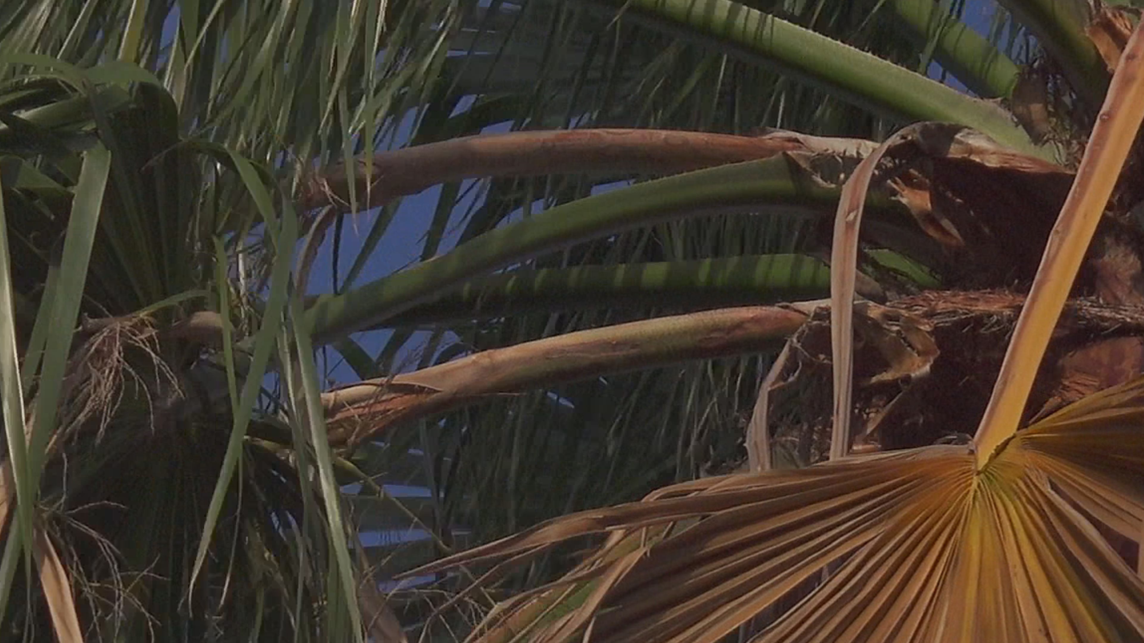

OK,..just did a super quick...VERY quick stress test. Both files are the exact same zoom/crop.
These are two frame grabs. One set is 60Mbps and the other set is 100Mbps. Each set has 1 color and 1 Luma channel view only.
Let's see how good our eyes are. Can you tell which set comes from the 60Mbps frame grab and which set comes from the 100Mbps?
Let's all toss it around and speculate. In a while, I will reveal the answer.
Yes, yes, yes...I know that is quick and unscientific. A more accurate test will happen this Saturday. This one wont be frame grabs, it will be motion video, side by side. Cheap consumer Handycam 100Mbp/s vs. Professional XDCAM, 60Mbp/s.
For now with have this to toss around....
Hmmm...who has the best eyes here? This one is not easy. Jody, Noah, David, Ron, Craig and anybody else, what do y'all think?
CT ;-)
Sony X70 4K - Lowest bit rate in the industry!-color-stress-frame-1-.jpg   Sony X70 4K - Lowest bit rate in the industry!-color-stress-frame-2.jpg
Sony X70 4K - Lowest bit rate in the industry!-luma-stress-frame-1.jpg   Sony X70 4K - Lowest bit rate in the industry!-luma-stress-frame-2.jpg

My guess is one on the left is AX100.

I don't see any difference, imagined or otherwise. Pretty much what I found with my AX100 60vs100Mbps testing.

Fair enough. I can understand that....
Did you inspect the color removed images?

JPEG compressed files not the best way to compare. PNG or TIFF might have been better.
