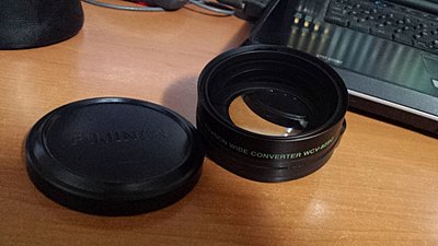

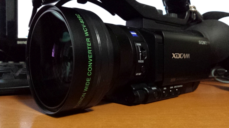

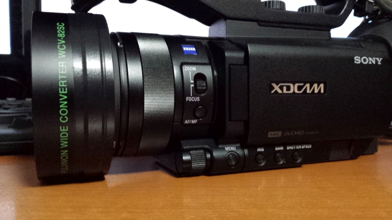

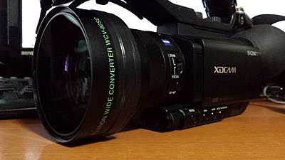

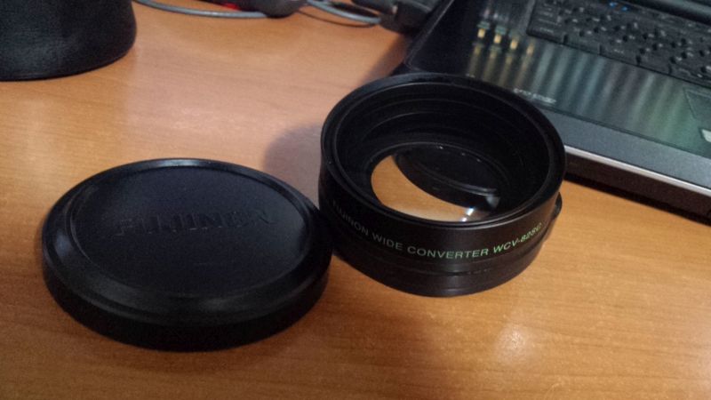

I don't know if anyone is interested but I've found a full zoom through wide angle adapter that works beautifully with the X70. A little distortion on full wide but totally usable. It's an HD Fujinon .82 x adapter that was made for the 1/3" 16x zoom lens that came with some of the later JVC HD 1/3" cameras.
I've had this lying around for a couple of years or so and saw it on the shelf the other day and thought "I wonder, hmm!"
It actually has an 82mm thread diameter so way too big for the X70's 62mm filter thread. The other problem was that the 82mm thread on the Fuji adapter it too far forward on the adapter for a 62-82mm step up ring to be fitted. With a bit of measuring I calculated that if I used a filter ring only off an old 82mm filter and a 62-82mm step up ring I would be in business.
Sure enough. I unscrewed the retainer ring out of and old 82mm filter, removed the old chipped filter element and then just screwed this now empty 82mm filter ring, now a spacer, onto the back of the Fujinon wide adapter. Next I screwed a 62-82mm step up ring on the old 82mm filter ring ring /spacer and Voila! I now had a nice full zoom through adapter that had an effective width in FF terms of just under 24mm. It works a treat.
What I like about this unit is that it was designed to work with an 82mm front objective but on a 62mm lens mount you are using the juiciest central part of the adapter only and are well away from the edges. It's nice and sharp right across its field of view at all apertures on the X70.
The other nice aspect of this adapter is that unlike many other wide adapters it's not conical, it has parallel sides. Most wide adapters are conical in shape and don't allow a small camera to sit flat on a flat surface. With this unit there is about 1.5mm parallel clearance between the bottom of the adapter and a flat surface such as a table top. Just to ensure the rings don't unscrew and for added security I just put a wrap of electrical tape around the adapter and the two rings.
Occasionally these adapters turn up on eBay. The model number is a Fujinon WCV-82SC. One went for $10.00 last week! These cost in the high hundreds when they came out. Great value if you can score one.
If interested have a look at the attached pics.

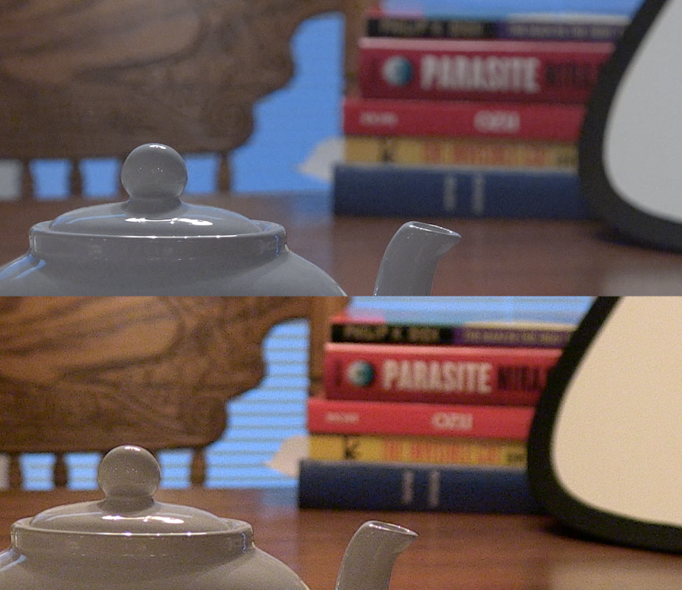

I finally got my X70 on Monday but have been unable to test it much until the last two days.
One thing I haven't seen is a depth of field comparison of the 1" chip. I've been using the Canon XF100, a single 1/3" chip camera. But the Canon's iris is 1.8-2.8, the Sony is 2.8-4. Does the Canon's wider iris negate much of the advantage of the Sony's bigger chip when looking for blurrier bokeh?
Well, the Sony *is* better, but not by a huge margin. I'm sure there are more combinations that would show more or less difference. I could get closer to the subject and have the background farther away and get more of the blurred background effect. But, here's what I did. Both cameras were set with iris wide open. I decided to set both at 80% zoom. The teapot is 6 feet from the camera. The books are 10 feet from the camera. Don't judge the color, saturation, sharpness, etc. - but the Canon is the bottom, warm looking sample. The Sony is on top and was shot using a flat PP I'm experimenting with that was not graded. You need to click to see the image larger to really get the effect.
Notes:
1. On the Canon, the book titles "Parasite" and "Ozu" are still pretty readable. I don't think you could read those on the Sony if you didn't already know what they said.
2. Note how the scrollwork design on the brown chair at the left is almost gone in the Sony version.
3. The blue behind the books and chair is an exterior glass door with mini blinds 3-4 feet behind the books. On the Sony the slats have mostly disappeared.
4. Finally, this was shot in very low indoor lighting. Note the graininess/noise in the Canon - it was at 12 db Gain. The Sony's Gain is tighter and smoother - and it was at 15db. The Sony was shooting the max quality XAVC 1080p60, the Canon its best 4:2:2 codec @ 1080p30 (it doesn't do 60p@1080.

Chris, I use an EXII that looks almost identical to that, in fact, I believe the newer JVC version is based on the EXII from 16x9 Inc. On the X70, it's almost impossible to tell it's attached. On a JVC HM650, the sides and corners are blurry and have CA. On my HM790, the corners vignette. Seems these adapters are just right for these little cameras, and really don't feel too odd or heavy once attached. 16x9 Inc provided me a direct 72mm thread to replace the stock 82, and a 62mm step down, so i can use it on the HM650 and the X70.
