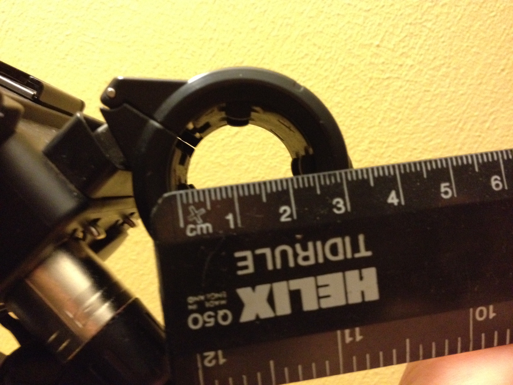

This is fairly trivial question, regarding the on-camera mic clamp. How much latitude is there for microphone diameter? I downloaded the X70 manual (still awaiting the camera) but oddly can find no technical details about this. I have a Sen MKH 8060, used mainly for boom pole work, but I might want to use it on-camera occasionally. The diameter of the 8060 is 19 mm, and I notice that your ME66/K6 gives 22.5 mm in the specs. Presumably the clamping mechanism will allow for some variance - but I have no idea the range.

Yes, that would be good to know. I have the AT 4053b, and even though it's listed as 21mm in diameter, on my XF100 it's too small for the microphone clamp and I have use a couple of rubber o-rings to make it fit.

Regarding the on-camera mic clamp, how much latitude is there for microphone diameter? I have a Sen MKH 8060, the diameter is 19 mm, and I notice that your ME66/K6 gives 22.5 mm in the specs.
Hi
The ME66 wasn't in the on-camera mic clamp, it was in a separate pistol grip. However, the ECM-XM1 (which is a basic top-mic I originally got with a Sony Z5) was clamped in the X70 though it has a rubber sheath around it which brought it up to the right width.
By holding up a ruler to the X70's mic clamp - see my bad photo - it appears as though the minimum width from the tip of each rubber mounting point to its opposite number is around 22-23mm so you're going to have to wrap loads of gaffer tape around that 8060 ;-)
Regards
