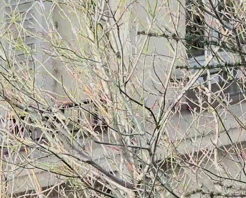

Just watch the first 30 seconds, it is as clear as day the encoding is suffering. Note that watching it downsampled will hide a lot of the issues.
Use VLC Media player, play the download clip, right click on on the playing video and unselect 'Always fit to Window' and it should now be playing at full size.
You can clearly see the encoder struggling and see detail vanishing then reappearing. At around 24 seconds look at the stair case and the detail coming and going with very slight camera movement, look at the balcony edges detail come and go, because the encoder hasn't enough bit-rate to cope with the movement.
The fruit at the 1 minute mark, you can watch the mosquito noise all over the fruit.
At the 1:27 mark look at the railings and bricks, covered in compression artefacts that flicker in and out.
Look at 1:47 with the building with scaffolding and the crane, looks a complete mess.
Look at 2:19 with the trees, a complete mess of compression artefacts. I've attached a 100% crop from 2:19. I could go on.
If this was HD no one would be interested, it is horrendous. Because it is 4K that most people are viewing on small monitors and downscaling everyone is having some sort of mass hysteria for it. It's laughable really to hear people go on about this, no compression artefacts, really?
It is what it is, 4 screens of poor quality 15Mbits/sec HD stitched together and shrunk down to hide all the nastiness.
As for the funny wobbling effect, it's all over the place, you'll see it more at full screen resolution.

The facts are we have 4K with each HD quadrant only getting 15Mbits/sec on the AX100, and that is exactly the quality I see, perhaps worse given the encoder can't make as much savings in motion search given it has to encode the equivalent of 4 HD images at the same time.
The main problem is everyone is viewing 4K down the wrong end of a telescope essentially, you can take anything and shrink it down and it appears to look sharper and more detailed. 4K isn't about shrinking down though, it's about a future of much bigger screens and enlarging.
It astonishes me that people are saying there are no compression artefacts in this Sony AX100 footage, but clearly it is riddled with them, again it is looking down the wrong end of the telescope.
Hopefully the original footage is better and the worst of the compression artefacts are due to poor encoding later, but we still can't get away from the facts. To have AVCHD quality but in 4K would require 28Mbits/sec * 4 = 114Mbits/sec encoding, and many would argue that AVCHD quality is already pretty poor. As the encoders are little more than HD encoders with the LSI overclocked (we've not seen new silicon yet, that will arrive with H265 hardware encoding), on 4K they are even less efficient.
So 15Mbits/sec per HD quadrant, it is what it is, and was always going to be a struggle for any camera. Perhaps the GH4 will be a little better with 25Mbits/sec equivalent per quadrant, then again, that still isn't that many bits per second.
Given the Sony AX100 will record HD in 50Mbits/sec at a smooth frame-rate of 60fps, that will probably be a lot more pleasing.
