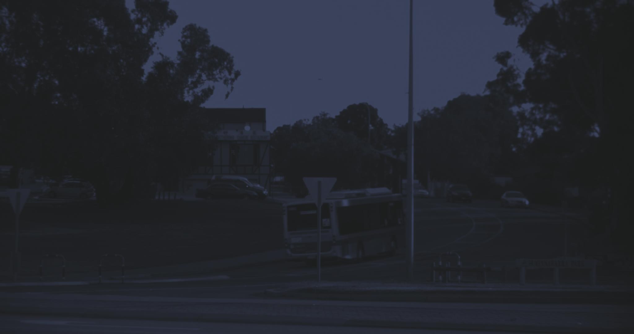

I have played around in Premiere Pro 2 in the cineform metadata place and have got to a look which vaguely replicates what I see as night. The sharp shadows are a dead giveaway.
However this look may prove to be totally weird to anyone else. This is what the dark looks like to me with brightness cranked a bit. My eyesight is next to useless in the dark.
All the changes are in metadata, not added effects.
The issue I now have is how to save and rename this as a new .look file that I can take back to the SI2K and try out. Can this be done out of Premiere Pro and the cineform metadata utility?
I also stumbled onto close to the evening Gevacolor XT320 with 81EF filter appearance but lost it.
Any clues are most welcome.

Hi again Bob,
I haven't tried this but there is a way to export a look from Prem Pro with Prospect 4K installed.
With the look you want applied to a clip select File/ Export Movie/ select CineForm Look Exporter.
This is ment to give you a look file that you can then use.
I'd say you are on the right track with your DFN look but the sky and lack of car lights don't help sell the look
No, you must use SpeedGrade OnSet, etc. for .Look file creation. We are actually running the SpeedGrade engine inside the camera, so it needs the settings from the XML file in order to properly regenerate the .Look file in-camera. A CineForm LUT on the other-hand is just the 3D LUT portion (or at least it is not a IRIDAS SpeedGrade compatible XML).
