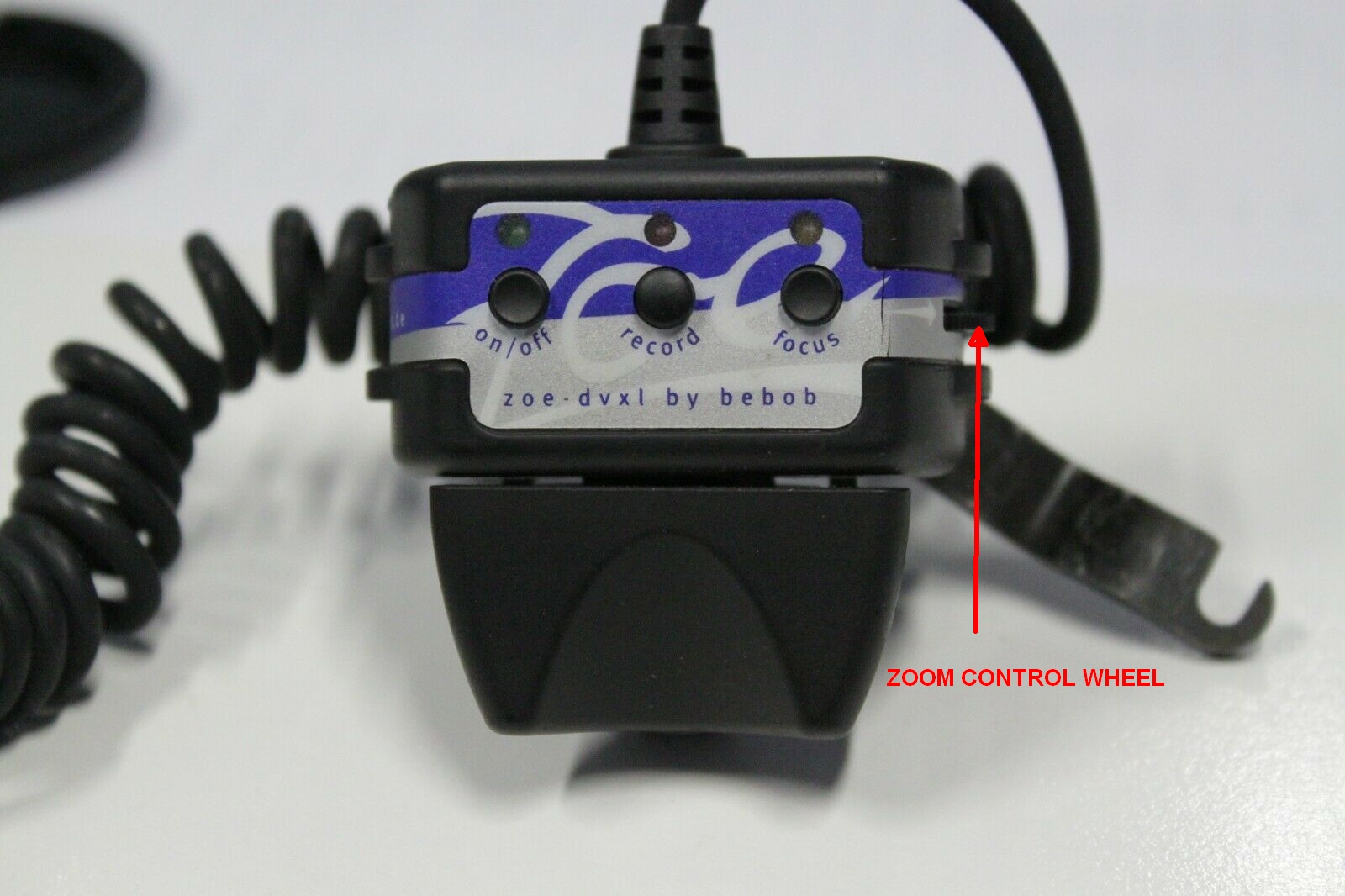

The ones I use are no longer made. They are the Zoe DV Lanc controller from Bebob Engineering. I have four of these. Three of them with the switchable Sony/Canon Lanc protocol and mini Lanc plug plus one with the dedicated 8 pin connector for the EX series cameras.
They have a dedicated zoom speed control wheel on their right side. The earliest versions didn't have internal end stops on the speed control wheel and subsequently quite a few got over driven and the internal contacts were damaged. Later versions had a limiter pin built into the control wheel which solved that problem, unless you were totally ham-fisted. Ham-fisted people were even able to shear the internal center pin on the wheel where it pluged in to the internal potentiometer that controlled the speed. The later ones depending on camera will give you a zoom speed variation of between about 2 to 30 seconds depending on the pressure applied to the control rocker. This is camera dependent. Dependent on the actual capability of the zoom servo on the camera.
With the EX series and earlier HVR-Z1 cameras and the Sony FS7 I find they work very well. With the laterSony Z90 which now has a Lanc port I find you need to have it connected BEFORE you power up the camera. Because if you don't you can get some funky behaviour, like slow creeping zooms without you even touching the controller. Download the manual here:
https://www.marcotec-shop.com/pub/me...ser_Manual.pdf
As luck would have it when I looked on our local eBay there is a new one listed.They were around AU$300 when new. This one is listed for AU$200.
https://www.ebay.com.au/itm/Bebob-Fa...4AAOSw4JBfj7ui
No guaranties that it will work 100% with all it's functions on the X160 but the zoom side should be okay. For example the auto focus functions won't work with the Z90.
If you want to understand the ins and outs of these Bebob controllers and how to fix issues with them such as the slow creeping zoom adjustments check out the discussion below. I guess it's okay to post help links?
