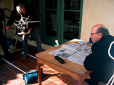

Thanks Eric! I just finished shooting my short "It Ain't Easy Bein' Dead" and if I uploaded it correctly, here's a photo of Mike Ferris (one of the top operators in Hollywood) using the dolly with the short jib; "The Killer's Kiss Crane". I've never upload a photo to DVinfo, so I hope it shows up!
Dan
www.DVcameraRigs.com

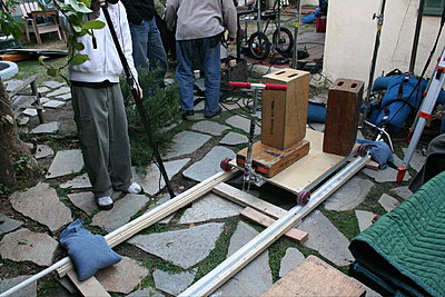

You don't have to use the L-brackets. You can use any angle (L shape) aluminum or steel and run them the entire length of the dolly. In fact, your bed is probably sitting on angle steel. Take a hacksaw to it! You just need to be careful drilling the holes for the axles. Make sure they are ALL the same distance from the bottom edge of the angle or your dolly will wobble. To attach it to the platform, use smaller bolts than in the book. 1/4" or a little bigger along 4 spots on each side. When drilling into steel, aluminum, etc. MAKE SURE YOU CLAMP YOUR WORK!!! If the bit catches the steel will go spinning into your flesh if it's not clamped down.
The advantage of using angle the entire length of the dolly is it will hold a lot of weight without having to double up on the plywood. The disadvantage is you can't take the brackets off and move them to a different size platform. I have 3 platforms: a 12"x12", 24"x24", and a 3 foot by 2 foot that uses angle. I'll upload a photo of the one with the angle, so you see what I'm talking about. It uses a razor scooter as a handle and has scooter wheels. The only reason I'm using the larger scooter wheels is I found them on sale super cheap.
E-mail me if you have any questions: dan@dvcamerarigs.com
