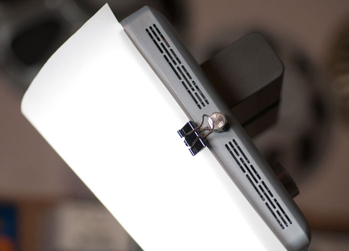

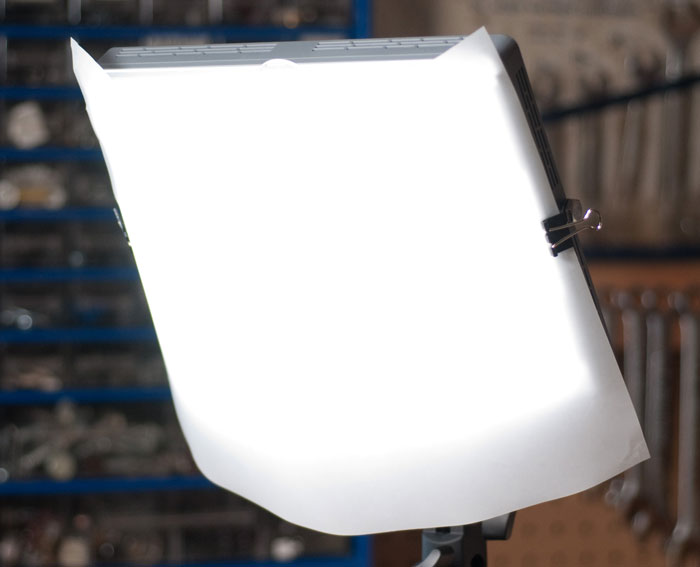

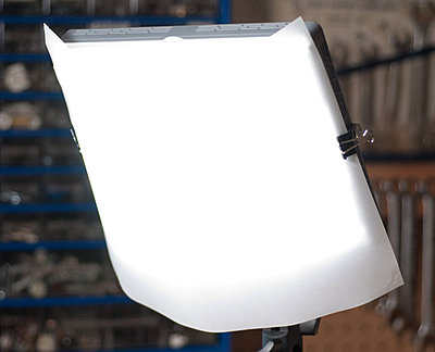

I also thought of a cheap and handy way to attach filters to these instruments. Simply mount paper clips to the attachment points on the sides of the light. I went to the hardware store and got some bolts to fit, and some washers. Already had the paper clips.
Seems to work quite well.
