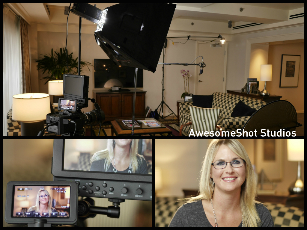

Luke, the multi-LED units do not lend themselves to barn doors, as you speculated. When I've got the luxury of space and I'm not worried about spill, the Aputure panel is fine. The level is low enough that it won't overwhelm ambient in all but the darkest rooms. Keeping it super-close to the talent helps.
I also attended the Hurlbut workshop and liked the idea of large, round beadboard bounce, but you can't really travel with it, and setup is more of a hassle in the tight rooms I often deal with. 5 in 1 has worked well and travels much easier.
My go-to portable setup is shown below.

Thanks for posting those shots! They look great! I see the Alzo w/ softbox in your setup shot with a 5-in1. Is that rim light the lowel pro?

The hair light in my shot is the dedo. But a Pro Light would have worked just as well (so long as you can snoot or narrow it properly).
