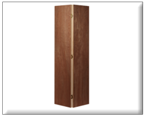

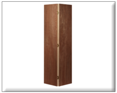

Ideally you would have a larger area so the subject is farther away from the BG as possible, and thus using the inverse square law to your advantage.
One thing I use in photographic work is a set of bifold closet doors, painted black, just out-of-frame to help absorb some of the light reflecting from the BG.
The doors can be found at local big-box hardware store for about $30.

1. Take 2 sets of those bi-fold doors a couple of posts above. Cover the side that will face the white background with aluminum foil - shiny side out (use contact adhesive such as 3M 77 in the spray can to attach foil).
2. Mount 6 or so Edison sockets along one side near the center hing of each set of doors. Wire them up and install the highest wattage bulb you can still get.
3. Position them facing the background and adjust to get an evenly lit background.
You should be able to put that stuff together including the doors for under $100. It will be a much more even light than the construction lights.
