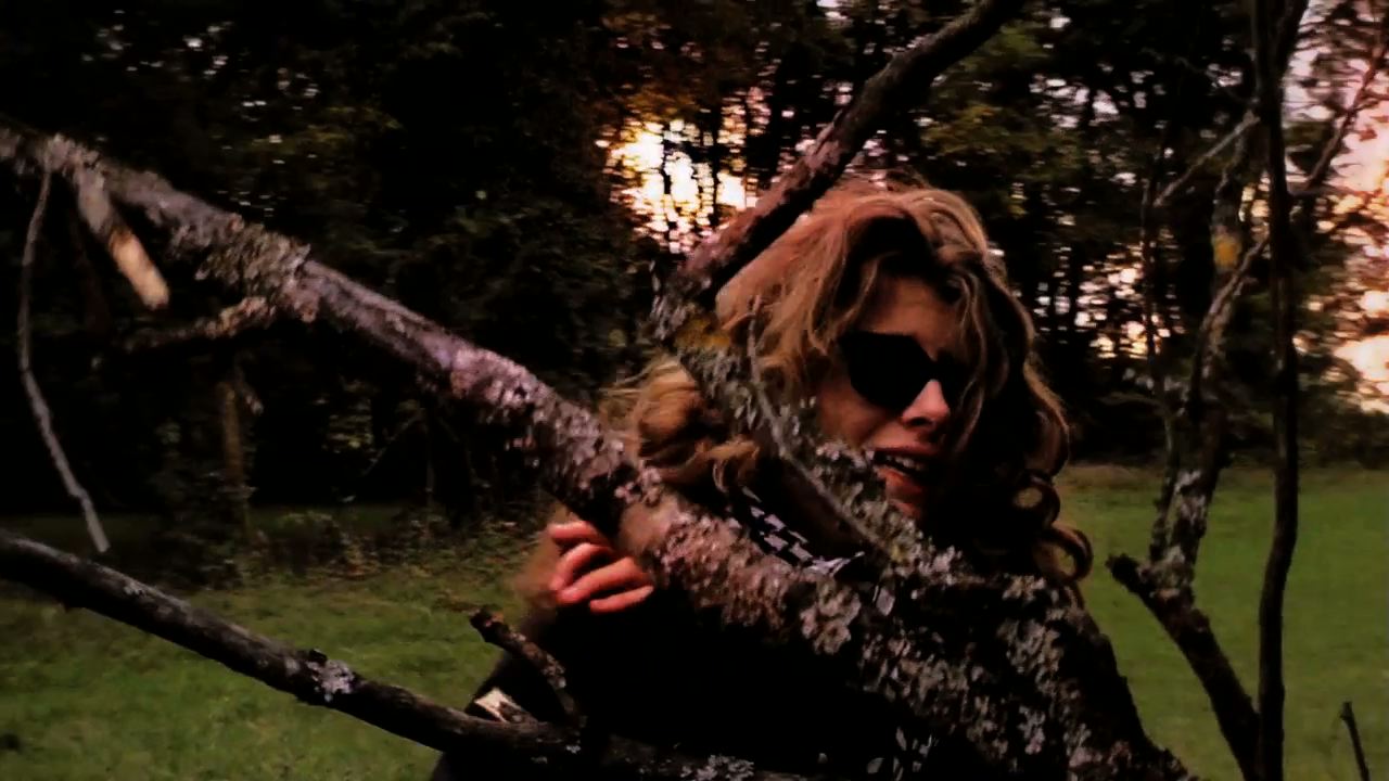

Is that framegrab showing a frame where you see green on the actress? If anything the skin tones look far too red to me. Perhaps it is a bit green, but its hard to tell with all that red.

That frame grab definitely looks red, and not green, to me. Certainly the actress's skin looks reddish-orange. Also, the skin tone looks rather dark, although of course I don't know this actress's complexion. Other than that, the frame seems to have rather high contrast, compared to what I'm used to seeing.
In fact, the sky (seen through the opening in the upper right corner), where it is not blown out, looks pink; it measures roughly R=240, G=210, B=200, definitely reddish, not greenish. In the middle of the frame, it is slightly yellow; I find some spots R=250, G=220, B=180. Definitely nothing green about this sky. Unless it's shot near sunset, it should tend toward blue, and not toward red as it is here.
I wonder if your camera's exposure, and maybe also white balance, are being thrown off by the two very bright areas of sky. How did you get your white balance for this frame? Was the white card positioned where the actress's face is located, and zoomed so it fills the entire frame? I would think doing so would give you a drastically different balance from what I see in this frame capture.
Caveat: My monitor was adjusted by eye using bars, but is not truly calibrated. But I do watch a lot of video on this system, and I don't think I've ever seen skin tones like these. The above measurements of sky are taken directly from your frame grab. I am especially surprised that anyone would see this frame as being predominantly green!

The picture I uploaded is the wrong one - my total apologies. I'll learn how to use the site's tools correctly and upload pertinent material - screenshots which illustrate my point - in a few days, and also give some lighting specs.
