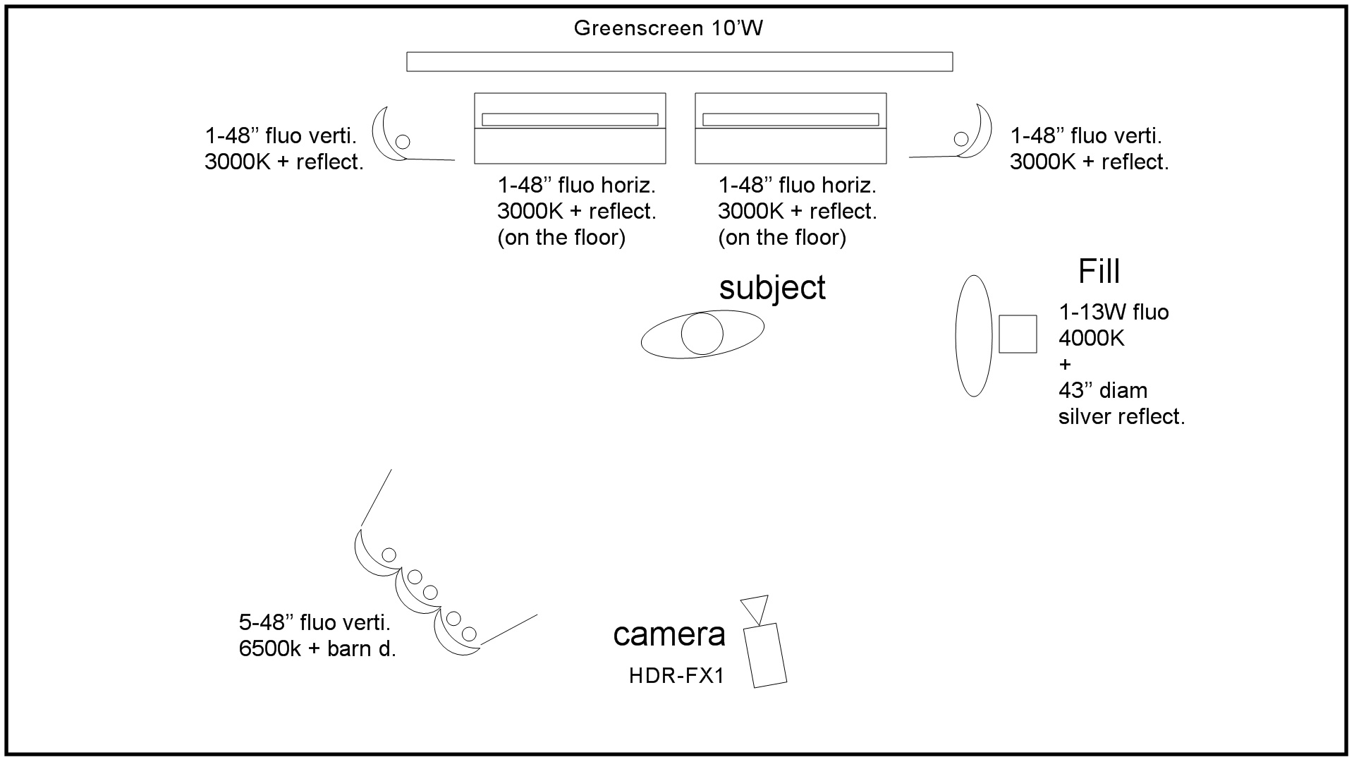

But to get back to the main subject of this thread (lighting)
Ok so I have to work my white balance on the site and find the right settings in post-production but overall is the lighting method I use acceptable for a presentation type of video (were the subject talks to the camera) or would anyone sugest any changes, keep in mind this is all DIY stuff, so if you propose anything I will probably end up building it myself but that's ok I don't mind if it's really gonna make a difference.

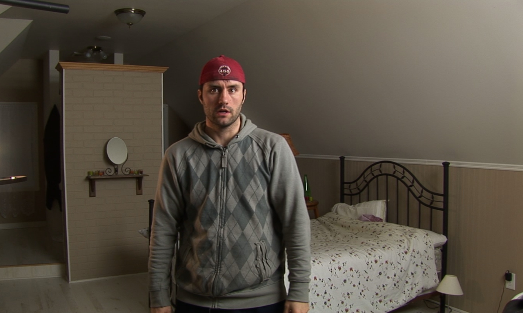

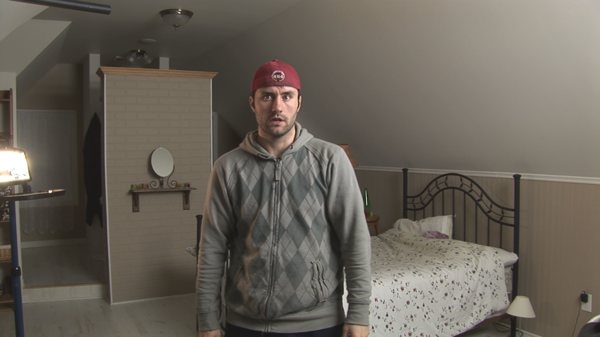

The aesthetics of the lighting are a bit more challenging to be definitive about, now we're getting into conventions, opinions, style, etc.
Per some common TV conventions, you have very flat lighting on her face. A lot of people in TV say "great, you can see everything, no shadows, great lighting". Some people in fashion will say "that's how you light a pretty woman - flat lighting is glamorous".
Some other people will say "so flat, so lacking in dimensionality and depth".
Do you want more dimensionality and sense of depth in your project? The film-y lighting conventions say "yes", but really we're down to artistic/aesthetic choices here.
I'd say that in this scene the 6' wide key is too close to the subject and too low (probably restricted by ceiling height). Too close in that the "wrap" effect of a large source is exagerated - you have as much light on the left side of her face as on the right, with almost no shadows. To low in that the shadows of her nose & etc. are falling almost sideways, not down & sideways.
So I'd shoot with taller ceilings, run that flo light up to about 8', get it further away or mask half of it to make it a smaller source, then check out how the shadows are looking on a monitor. Maybe some fill will be called for, or less masking or closer key, or a reflector for fill. The aim here would be some shadows from her nose and in her eye-sockets, but not deep shadows - there would be detail in the shadows.
It is impossible to evaluate the backlight because of the natural sources in the room. We don't know what's coming off the backlight and what's coming through the windows, but it looks OK in that she is somewhat separated from the background. We don't really see hair highlights, we don't really see rimming light, both of which can also help bring out dimensionality.
In part, I think this is because the backlight is not really placed as you diagrammed, but more to the side. Which, with a large source like this, is further flattening things out. Typically, backlight is created with a more directional source.
Finally, I really don't like the effects of the smart smoother mentioned in your original post. To me it makes her facial contours, especially between her nose and mouth, rather cartoon-ish. Hair detail is very unnatural.
Having said all that, I've seen plenty of corporate video lit flat... "information video where the subject talks about a product or a company". To my way of thinking, flat lighting is just another choice, another aesthetic, but you really should know how to light dramatic, how to light flat, and everything in between.

Donald,
I would try to test these lights in a room without windows and see if you can get a good color out of them.
Your image has a lot of colors going on and removing the windows would take a variable out of the mix.
Also, the long tubes are not the best application for a hair/back light.
If you could find some higher CRI tubes, these lights would be best for lighting the greenscreen since they are long and would provide even light over a large area.

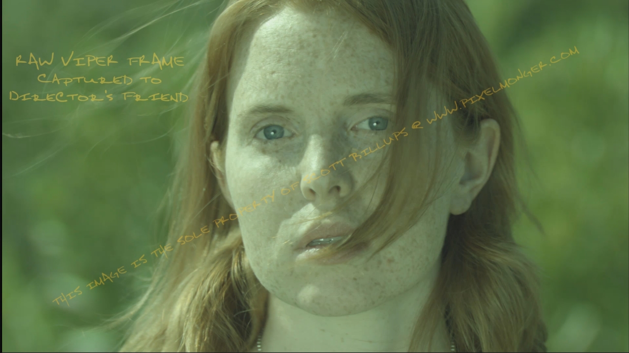

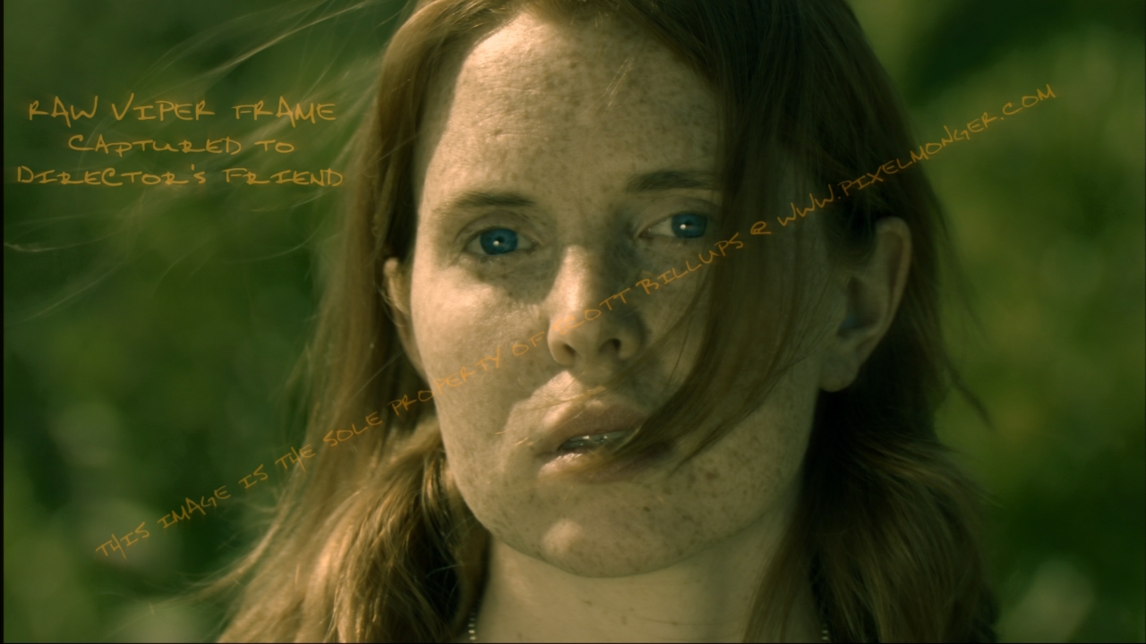

You're welcome. But remember, I did that in 10 minutes without the aid of my monitor which is still out of commision until I get everything hooked back up tonight or tomorrow. So that was a quickie.
I separated the exposure correction from the color correction for two reasons:
1. To make it easier for you to see what I did.
2. Because sometimes when I am doing a bunch of work, I like to turn off certain things I've done, and see the before and after. Like working on her skin tone, or bringing down the brightness of the windows behind her (which I didn't do in this quickie). When you separate things, it's much easier to go back and forth without affecting EVERYTHING so you have more control.
Color curves are delightful for making large corrections in video. If you want to adjust the color in different parts of the spectrum. It can be a fine tool. I just don't fine the need to use them. I prefer to work a different way.
There are many, many ways to get what you want out of your photography or cinematography. But they all start with having an idea of what you WANT, and them trying to get it.
I'm going to attach a copy of my practice piece to this message in a minute. Let me know what you think.

Firstly, this is not my image. I never intended to post it, just use it for practice with color grading. I use it to work my skills with the color wheels, curves, and other tools. I was wondering if you would notice the different things I did. I am glad you picked up on the eyes.
The green tone in the original photo is because this is a shot from a Viper. The same kind of camera used to film Benjamin Button. The RAW images coming off the camera have that green tone naturally. So the first job is to get the image back to neutral before doing anything else. So what did I do?
1. Correct green tone to neutral.
2. Correct exposure by fixing contrast, and stretching the contrast a bit further than I would for use on TV. I set it up like I might do for film.
3. Set the mood to late afternoon. I usually do this in the highlights, but it has to be subtle.
4. Adjust the mid-tones to get the skin coloration correct.
5. Adjust the dark tones to compliment what you do with the highlights. I often go subtly the opposite way with the darker tones as it gives the highlights a bit more pop. Cool tip I picked up from the guys who graded "The Other Boleyn Girl".
6. I changed her eyes. Her eyes are actually gray. Against the overall green hues in the photo, I felt it would be awesome to give a girl with freckles, blue eyes. They came out really well. I zoomed in pretty tight to make sure the mask was good when doing the color replacement, and it came out pretty nicely.
7. Added "light rays" just a subtle effect to place some warm afternoon light off to the left side of the shot where it would have naturally fallen when this was taken.
8. Darkened the foilage behind her in spots to get her face to pop off the background a bit more.
9. Ordinarily, I would have added just a bit of black frost, but since I was working in Vegas 8.1, I didn't have the plug-ins, so I just left it alone.
And you see the finished result. Total time to get the look, maybe 30-45 minutes.
As to your question, I don't know that it adds more render time but it might. But when I do this kind of work, I'm never in a hurry. Getting a rich palate of colors really add so much to watching video or film, I think it's worth the wait. And ALWAYS grade in 10-bit codecs or better if you have them. I also work in Vegas's 32 bit float mode because I can be a lot more precise. And when I render out, things look the way I expect them to.
-P

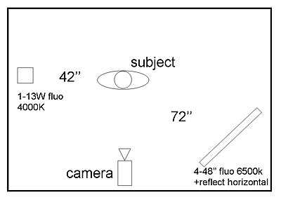

Ok here's another test with yet another question, can I mix colors temperature? 6500k and 4000k in this case take a look at the JPGs. I wanted a little more depth in the subject's face like Seth talked about.
Wow Perrone thanks for the details, would you've done masking (eyes) like this if it were a film clip instead of a still?
