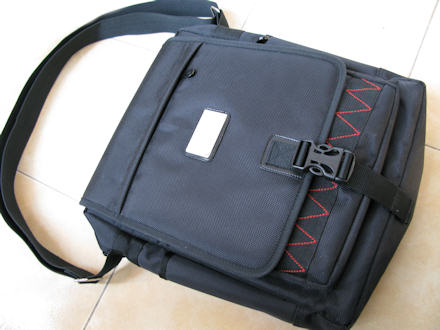

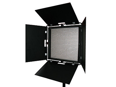

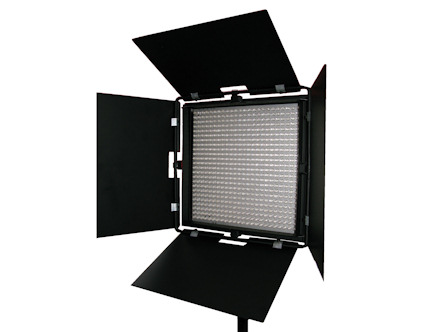

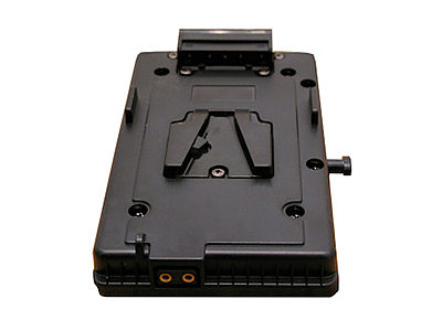

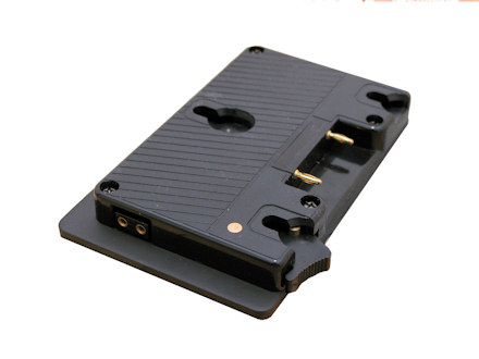

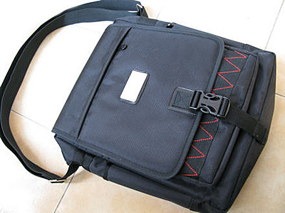

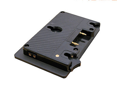

Cool Lights LED 600
So we're getting closer on our LED Panel which is in production right now. The CL-LED600 should be out in early December if none of our other products hold it's availability up since a bunch are coming at the same time.
600 LEDs, 9 5/8" x 5/8" x 2 3/8" size. About 3 1/2 pounds weight (or so). Removable barndoors that slide out of an accessory holder. Angle adjustment stand adapter. Black powder coated aluminum construction. 12VDC power supply included: approximately 50w draw at 12VDC. Power input is via 4 pin XLR. Power supply includes a 6 foot cable from power supply to LED fixture and a 15 foot IEC type cord to power supply which has a carabiner on it to clip to some part of a stand rather than leaving it on the floor. Also includes a dimmer pot and bank select switches on the back. It will have two accessories as of right now that can also go on the back of the unit: either an AB Battery mount or a V Battery mount that can go on the back--customer installable. You can either get our battery mounts or probably use other ones too but I haven't tested any others than ours. The pricing for this panel will normally be $479 and $125 for the AB Mount accessory, $125 for the V Mount accessory. For a limited time, we'll be running a special for $379 for the panel and $99 for the battery mounts. As if all this wasn't enough, there is also a free padded nylon carrying case very similar to a laptop type bag but custom made for this panel. The size of the carrying case is 12" x 14" x 5 1/2". Pictures below.
Available in daylight (5600K) and a limited number of tungsten color units (3200K) available as well. Thanks for looking.
http://www.coollights.biz
Richard Andrewski is offline   Reply With Quote
