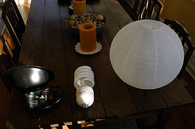

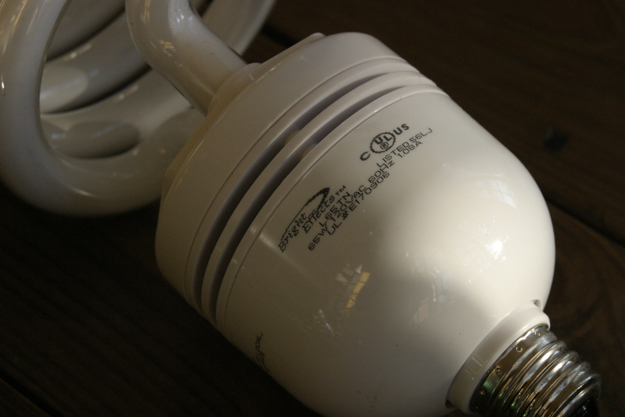

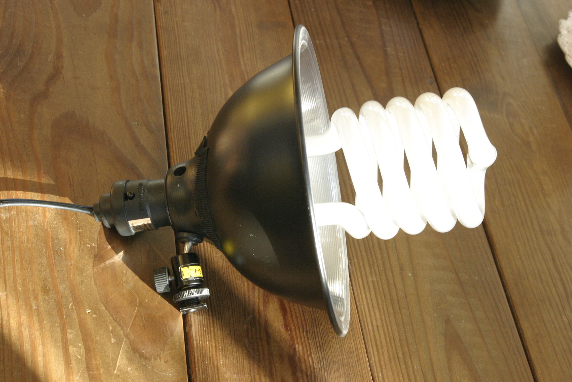

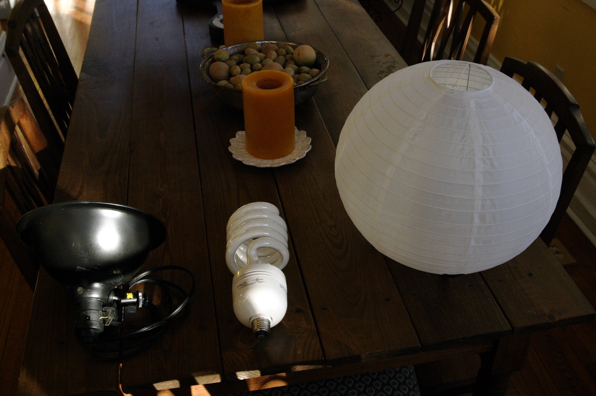

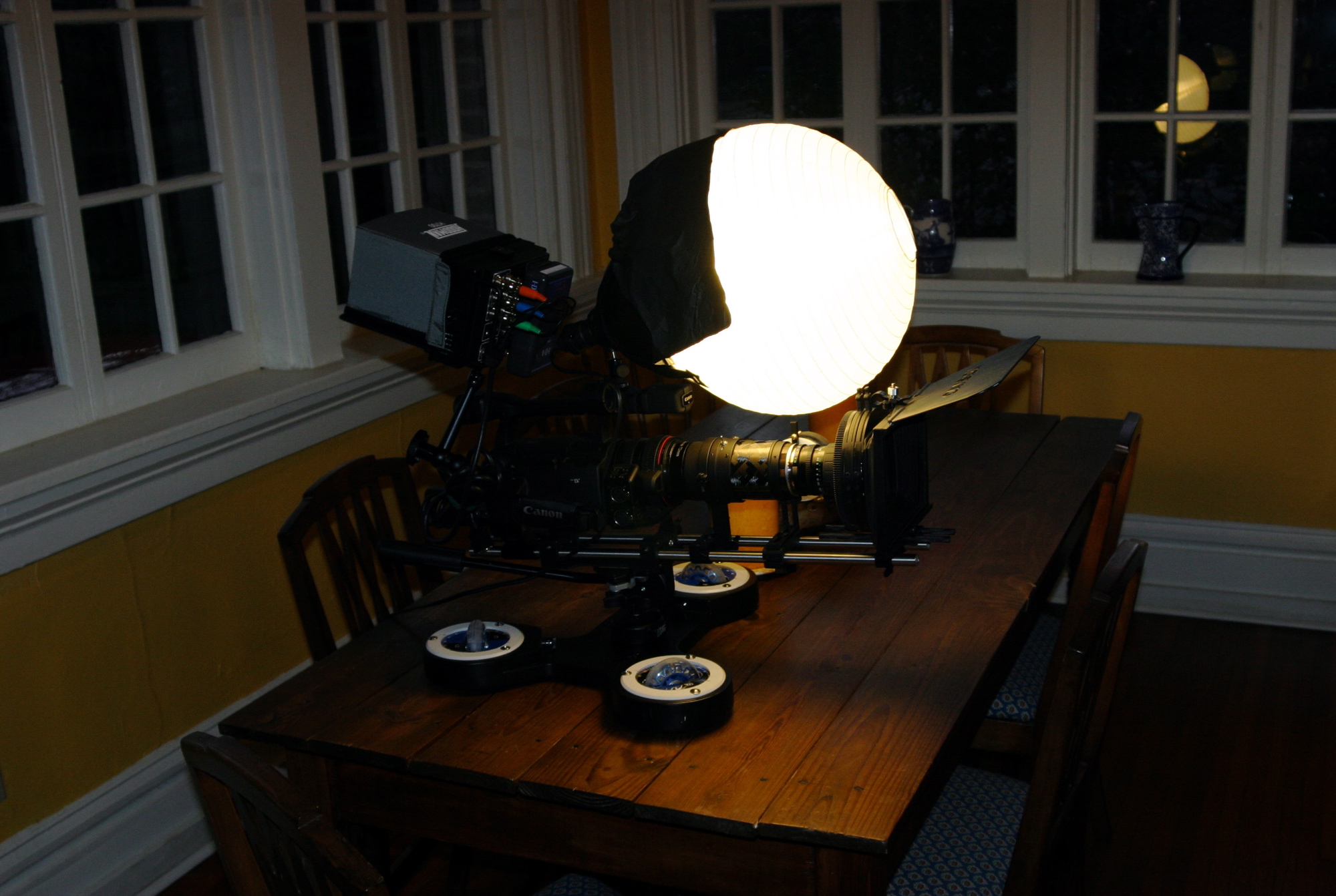

Just purchase normal Edison household CFL's in the proper color temp your looking for.
I have had great results mixing homemade CFL rigs with my other lights.
Old February 10th, 2008, 06:24 PM   #7
Location: Little Rock
Posts: 1,383
65w 3200k CFL setup.
Chinese Lantern with Florescents-65w-cfl.jpg   Chinese Lantern with Florescents-65w-ii.jpg
Chinese Lantern with Florescents-setup.jpg   Chinese Lantern with Florescents-mounted.jpg
