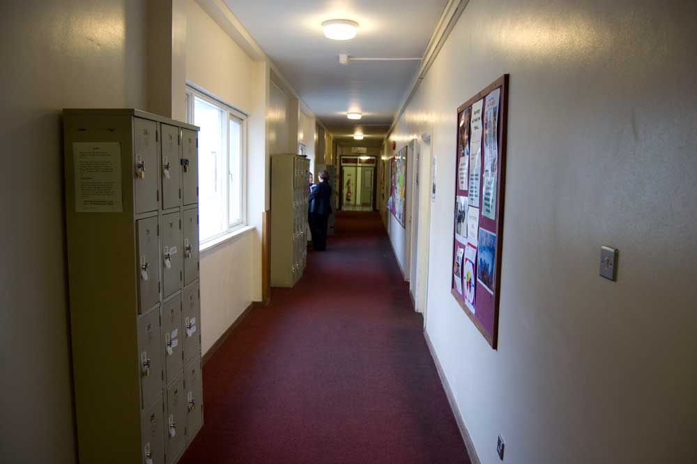

This is the other corridor i can use, any comments on this one?
Tony Webber is offline   Reply With Quote
Old November 27th, 2007, 06:47 AM   #21
Location: Belfast, UK
Posts: 6,158
Very different corridor, you should pick the location that best suits the mood of your scene.
In this case you have daylight coming through the windows. Are these south facing, so that you have direct sunlight coming in?
The glass doors at the far could cause problems with reflections from your fill light and possibly the crew if you're filming at the far end.
Given you're dealing with daylight here, perhaps the easiest way is to go with it and using the light coming in from the windows. Although you could colour correct the windows by filtering them to covert their light to tungsten, however, I suspect it would be easier to just use CTB on your redheads and use the method from the previous corridor to light the far end.
You can use the moving fill on the faces so that they don't go too dark between the windows. Leaving the glass door at the far end open would avoid reflections.

Just for what it's worth, this corridor doesn't feel as much like a "real" school to me as the other one does.

yeah it is a pretty different corridor,; the film is a light hearted teenage romance, the windows are north facing.
both locations are in a college, i havent found the perfect corridor though but i can shoot there for free.

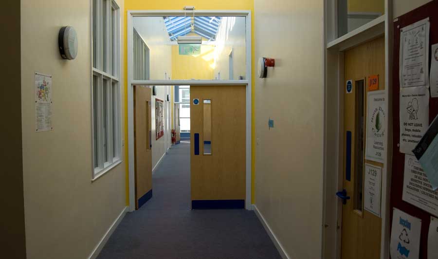

and this is the final corridor, its in a newer building. Again a different feel, lots of daylight from skylights.
not really sure which one would look best and be easiest to deal with.
any opinions on this one?

Looks like less issues with contrast in that corridor, although it's hard to tell if the skylights continue in the foreground and we don't know how long your walk and talk will run. If you can contain it all in the lit section, you are in good shape. You might still need daylight walking fill with the camera, which will be a bit tough with the instruments you have, but even if you don't have it the ambience is probably OK to do what you need to do, you'll just want to supplement a bit for closeups if you have them (even a white bouncecard held under the faces should cover you)

Seems to me as though time of day could be a rather large factor as well. If you have it narrowed down to a couple of sites, you might want to see, (if possible with a stand-in and video camera), if a certain time of day may give you more favorable conditions.

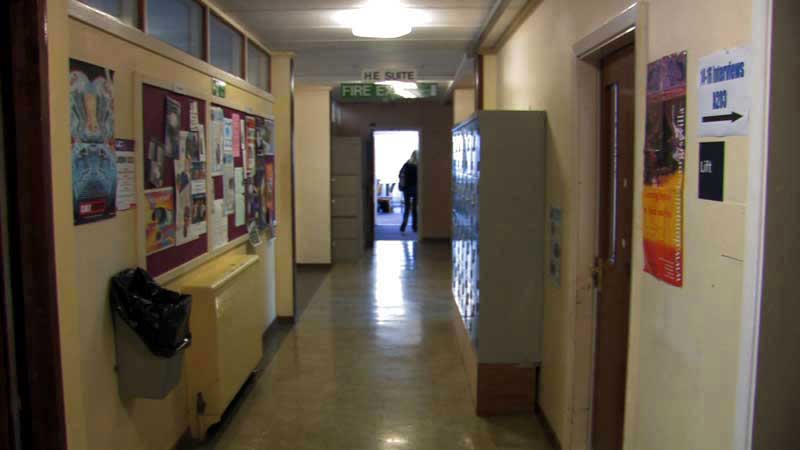

Did another location scout and found another suitable corridor. what do you reckon on this one? It goes on a bit behind the camera and there is another stack of lockers to the left behind cam.

What do you think? I'm not sure what you are asking about anymore. Two things come to my mind right away.
As director, which corridor suits YOUR needs and eyes vis a vis the script? What looks like the school that your characters would inhabit? Also as director, what blocking/action takes place? Is having a locker jutting out good or will it just get in the way of the actors or camera op when they are walking?
As lighting cameraman, which corridor is the easiest to light? Or, which gives you the most opportunity to create a certain mood?
Given that it is a romantic comedy, and assuming you don't have a large budget or lots of experience, the corridor with the skylight, especially at a time of day when there is plenty of light, (but not directly shining through the skylight), looks a good bet. But really, at some point, you as director, and or DP, have to make the call. That's why you are earning the big bucks-(euros?)!
