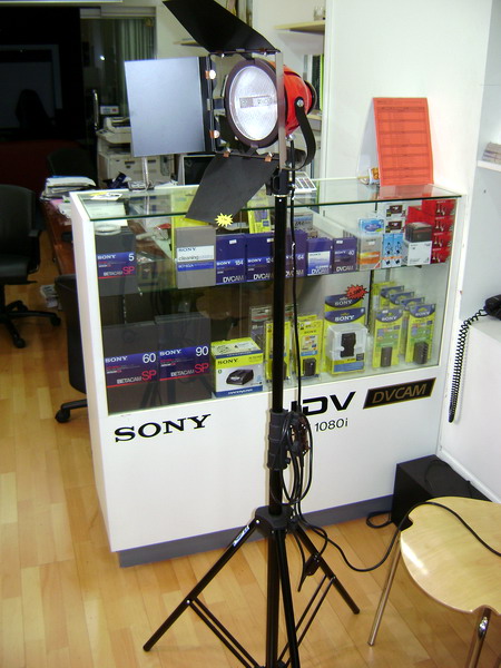

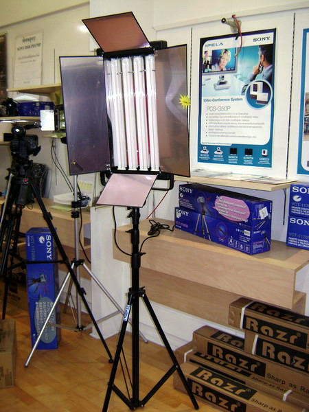

Here are pictures of the Fokon Chinese-made lights I can get quickly from Bangkok. I'm pretty sure I'm going to order the fluorescent unit so I have something in time for the first 3 jobs which are 1/2/3 December. Any thoughts or comments?
I asked the same question on the very helpful Sony Vegas forum.
I'll also be taking along a load of screw-in fluorescent bulbs and will probably build a "Nanolight" fixture for 6-8 x 20W or 23W bulbs as an extra tool for future jobs.

That first fluorescent is like the coollights.biz CL-455 which I have used. A big daylight-balanced fixture is extremely handy if you don't have a lot of crew. A light like that is great for filling in an area that has natural daylight. The large source makes it have indistinct shadows like a softbox so it doesn't give itself away in your shot easily. I got two lights in one from that light since I bounced light off the barn doors for hard light on the subject and aimed the rest at a wall to create a soft fill. Use a few lights to make your background pretty and the big fluorescent and one backlight can take care of your subject. If you simply need to fill a subject backlit by a window, put a light diffusion gel over the big fluorescent and move it in close to make it strong enough to combat the sun.
Make sure you get fluorescent lamps that are the appropriate color temperature for your location. If you have lots of tungsten already in the location that you want to use, you may need to use 3200Kelvin fluorescents. If you have a fair amount of daylight coming in, you can use daylight fluorescents and maybe some gel to get the other lights the way you want them to look.

The Fokon "Kino Flo" type 4x55W fluorescent light is working well. We're mostly using it in bedrooms as a fill light, with the windows supplying most of the light. The clamp isn't very good and doesn't feel that secure. We also need to get a case for the head as we can only fit it in a large suitcase. Thinking of getting the local wetsuit shop to make a 7mm neoprene case for it unless someone has a bright idea. We'll make a case out of plastic pipe for the stand. We also need a gel to match it to tungsten for darker shoots. Anyone know what colour/number gel that would be?

Something you guys may be interested in... Instead of building a "flower" of curly-wurly CFLs we bought Philips Econotone 65W fluorescents, one at 4000K and one at 6500K. The 4000K one has been very useful for supplementing light in bedrooms as its colour temperature sits between the tungstens and daylight. They also make a 45W one but the 65W one is great. We couldn't get a china ball/paper globe for it anywhere here so I'll have to bring one from abroad.
Most of the lighting in the hotels so far has been low voltage dichroics, so we haven't been swapping out any lights. Time is rather rushed for doing that anyway and I'm not confident with the safety of some of the local wiring either.
