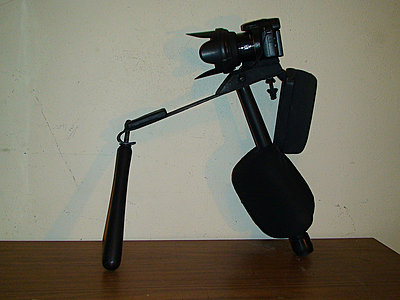

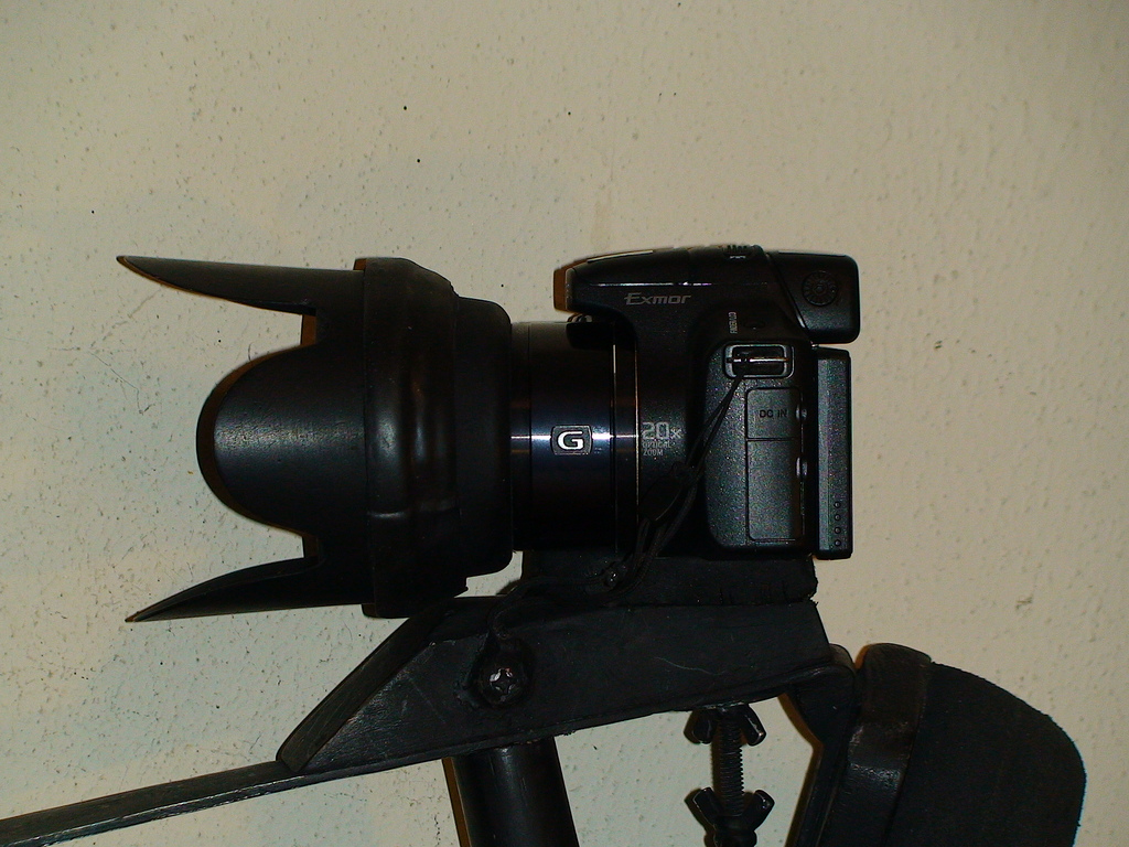

Attached are photos of my new steady-mount rig for the HX1. It has a 57mm to 74mm fiberglass lens adaptor tube I made and a fiberglass butterfly hood. Sony doesn't supply an adaptor tube with the HX1, that provides for the mounting of filters, hoods and add-on lenses, which I can do with this set-up. On my Flickr album, there's several more photos of other accessories I mount on the HX1 with my adaptors. I also have an adaptor that's 57mm to 58mm.
I've made a couple of similar adaptors for the Canon SX1/SX10, that are mounted by slipping the base of the adaptor over the outside of the lens housing, with some stretched wraps of self-fusing rubber sealing tape underneath, to compress and hold it firmly. I've already mounted one as a test on my Canon S5 camera and it works fine. There's a picture of this several pages back into my Flickr album. The SX1/SX10 have no threads nor a bayonet mount on their lenses, that are suitable for mounting heavy add-on lenses. The Lensmate company does sell an adaptor for them, that allows filters to be mounted.

Sony HX1 720p Video Looks Better Than 1080p-3552934485_5f36e3684f_b.jpg   Sony HX1 720p Video Looks Better Than 1080p-3552934481_ff5b139a2a_b.jpg
