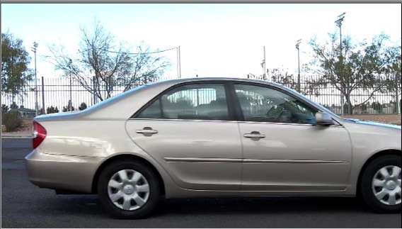

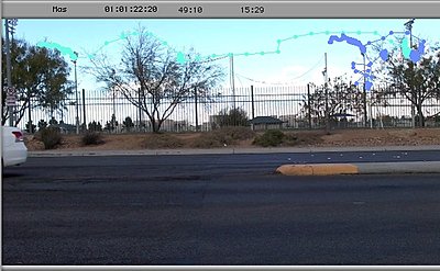

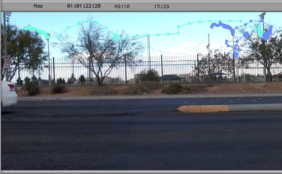

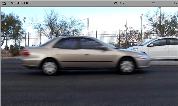

1) You can NOT set a slow shutter-speed (1/60th sec.) which means a strobing on fast action. There is a BS mode that promises a "low"shutter-speed. And, indeed the displayed STILL speed is a near perfect 1/40th second. This mode strobes like crazy! Looking at the picture, you can see there is NO motion blur at all from a fast moving car.
The other pix shows lots of motion blur and the video does not strobe as much. Yet this was shot in non-BS mode. The STILL shutter-speed was 1/320th second.
Clearly something very odd it going on. I continue to suspect the BS modes do not determine the movie AE operation.
2) The biggest problem with all these handholds is they are almost impossible to hold steady. (At least I can't.) One solution I've found is the Stabilize Video Filter in Avid Media Composer. It can track up to 4 points. (I use 2.) Like magic, the shot looks like I used tripod.
Also, avoid zooming and avoid any BS modes that turn-off EIS.
PS: an Avid Media Composer works perfectly with the Casio. The camera's SD card works as a source of QT files that are imported as 720p30 DNxHD files which work perfectly in a 720p30 Project.
Of course, 1080i60 files are handled the same way and work in 1080i60 Projects.
Casio EX-F1 Review -- part 5-flowing.jpg   Casio EX-F1 Review -- part 5-non-bs.jpg
