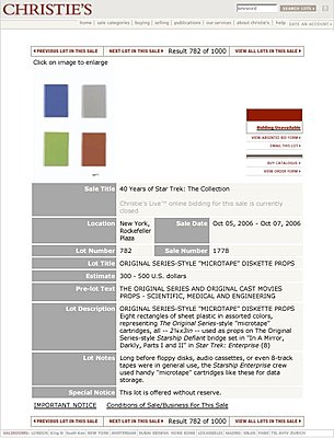

For all of you who are sitting on the fence regarding solid-state recording media, be aware that it will become the industrywide defacto standard.
Here's proof:
http://www.christies.com/LotFinder/s...jectID=4780346
Dean Sensui
Old October 7th, 2006, 08:13 PM   #12
Contributor
Join Date: Jan 2003
Location: Kansas City, MO
Posts: 4,449
Heheh--good one!
