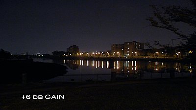

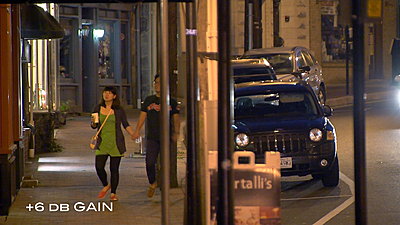

A few frame grabs.....
Hpx 600-panasonic-hpx600-night-grab-5.jpg   Hpx 600-panasonic-hpx600-night-grab-6.jpg

Re: Hpx 600
Thanks for the grab. Indeed there's noise if you look closely, especially at 6 dB and 12 dB grab. The noise will move if the clip is moving. For EFP, it's just unacceptable for me. However, for ENG, it's OK since content matters more than quality of the footage.
Judging from this, I suspect that it's roughly the same as the HPX3#### series cam which claims f/13 @ 2000 lux. I shot quite a few night time shots w/ the HPX3100 series and have been using 0 dB w/ pretty decent results. I'll grab some frames for evaluation. At 3 dB noise starts to get quite noticeable for dark scenes. If the night scene has a lot of ambient light, then I can go up to 3 dB max. This guideline holds true for the clip of the couple walking in the shopping area that you provided. But when the scene gets dark overall (no light on the grass and ground), ugly noise really starts to pop out. From 6-12 dB, way too much once the clip is playing its normal speed. It's like a swarm of noise insect invading the scene, especially the non-lit region.
