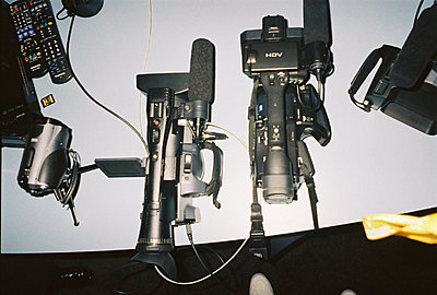

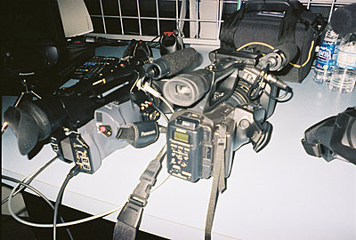

I got a chance to play with both cams at NAB I tried putting a card in the prototype to get some footage but the iris control was broken on the cam. The Panasonic Rep said the low light is going to be a 1/2 stop better. Very light weight almost 1/2 of my Z7u, No over or under cranking. I was ready to purchase one of these cams. I own the EX1 and Z7u but after seeing it in person I don't think so. It looks like they took the HVX and shrank it down same low res 4:3 LCD. The low light and the LCD was a breaking point for me.
