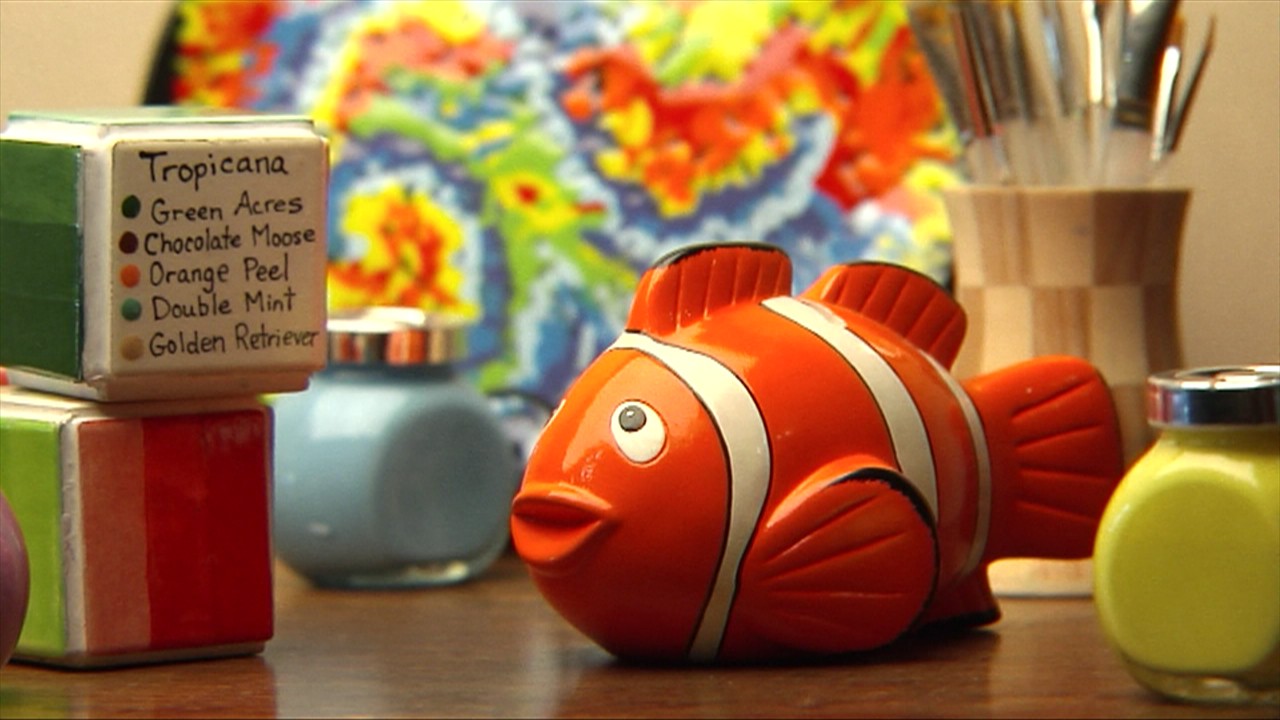

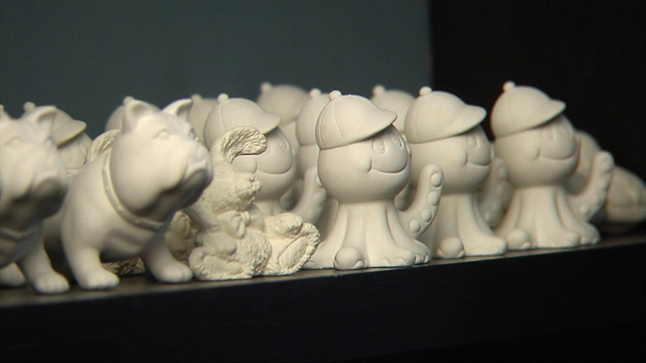

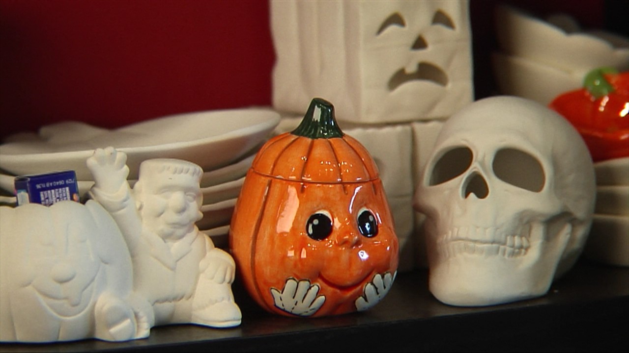

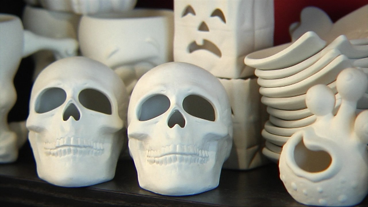

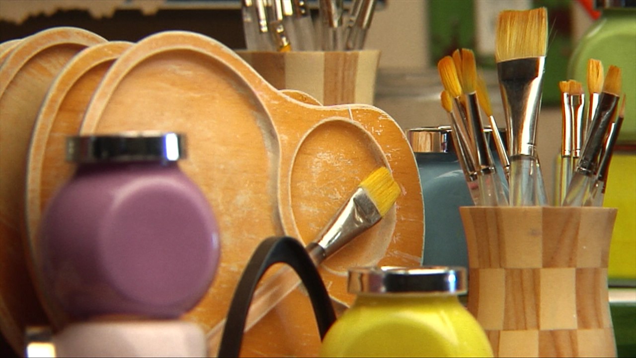

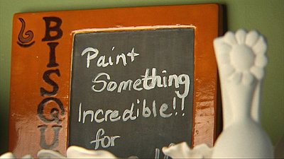

Shot some test footage this weekend with my HVX/Brevis/nikon combo. Here are a few still grabs. If you click on pic/link you can see full size. Would love to get some feedback. Thanks.

looks pretty nice. Wonder how the grain shows shooting 60p on that adaptor?

Wondering that myself. Hope to test other frame rates soon.
