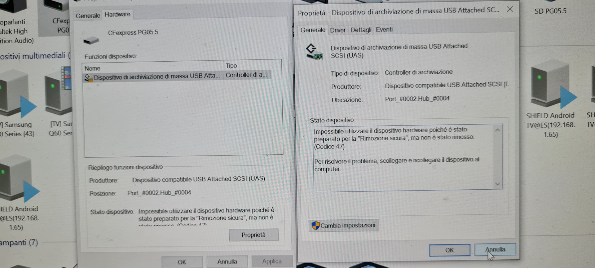

I assume the SD reader works? Also you only have one CFExpress card to try? Make sure the CFExpress card is really well inserted into the reader. It really does need to be pressed in firmly.. I find it hard to believe two reader are defective. Has to be the card or it is not inserted fully.

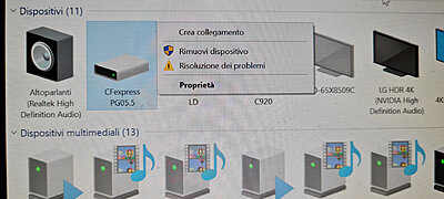

I would not want to waste your time with me to answer this question again but I would like to tell you that I have tried with 2 computers, 2 USB3 cables and with 2 CFexpress. I have 2 CFexpress cards that I insert them firmly, but I always get the same problem.

There are several other CFexpress readers you could try but not sure if there are many that have both SD and CF. Like Noa I still feel it is something to do with the PC as the reader works on all my PC's. I will try again on all my PC's with all the USB connectors and see if can get it to fail as it could be an issue of how the connection is made through a hub. Will report back later today.

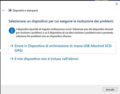

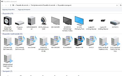

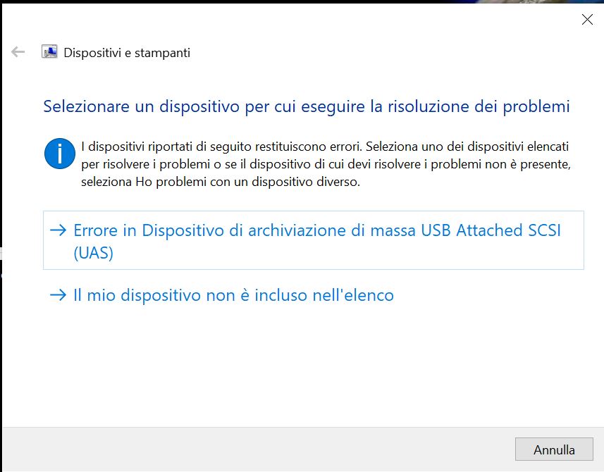

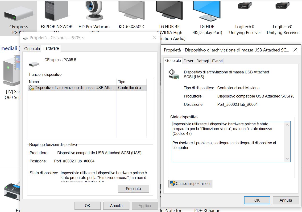

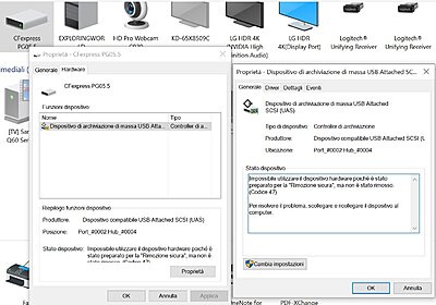

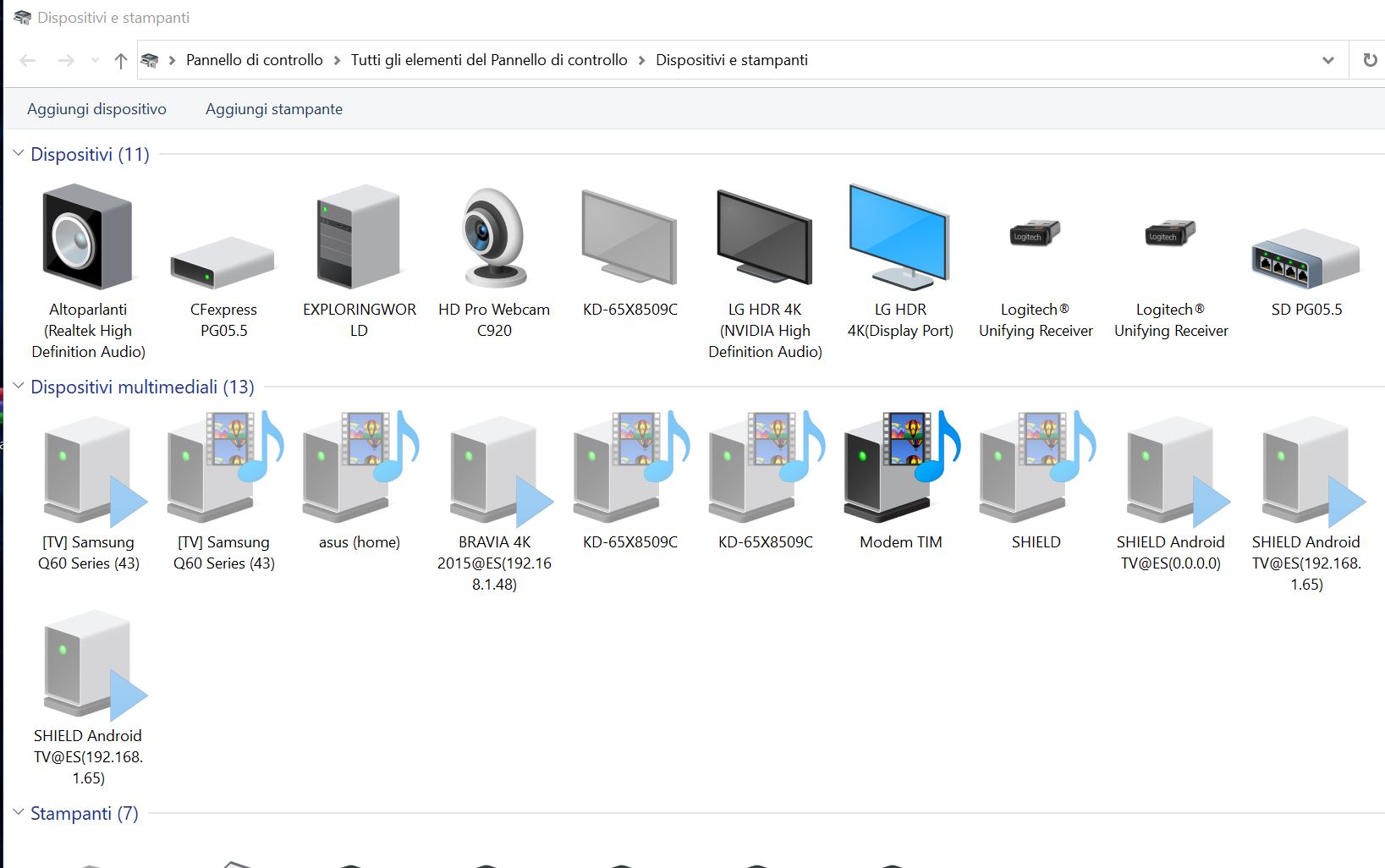

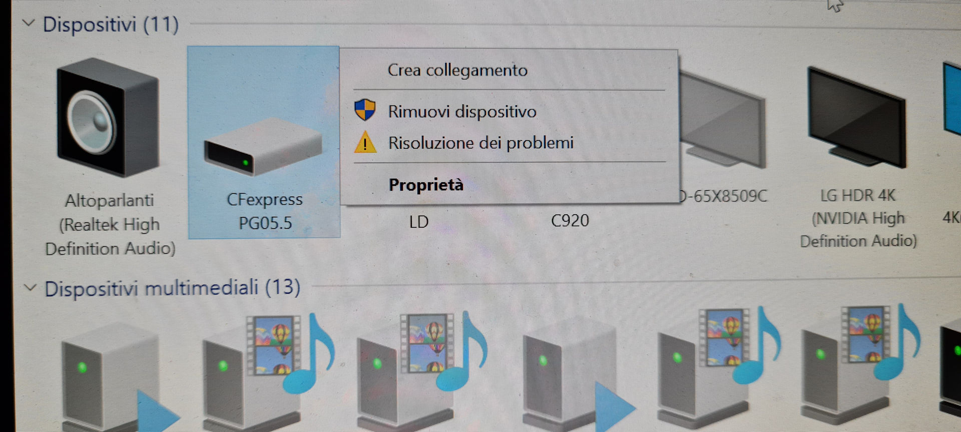

Unfortunately in Europe it is not possible to find Noa. There is Sandisk reader but it costs a lot more that ProGrade reader.
Anyway I like to inform you, I disabled all AUTOPLAY (for all the drivers) in my PC. I followed these steps: https://support.lenovo.com/at/en/solutions/ht502955
As the first 2 steps didn't work, so I followed the third step. Now my PC no longer loads anything in Automatic mode.
I attach some pics where you can see the error 47. But I don't know what it is.

Why did you disable autoplay?
I have now checked mine on almost all USB connection even USB 2 and it still shows and can be removed. Did you format the card in the GH6 and record something on it? Does it play in the GH6 OK ? Can you connect the GH6 to your computer with USB C cable and does the card show then.

The reason I disabled all the AUTOPLY, only to do a test.
I formatted the CFexpress with GH6 and with ProGrade I get the same problem.
I plug the cable on GH6 and the other end into the USB3 port of the PC and I can eject well, both the car and the GH6,repeat both work fine. It seems ProGrade is the problem.
