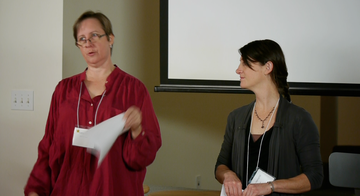

@William: I did just purchase the aforementioned Clip Wrap (I'm usually so easily swayed but I love the idea of people able to finally hand my footage off to a client when I'm not going to be editing in a format instead of having to Log and Transfer it so they can view it). As a test I rewrapped a few clips from that camera. Same interlacing issue and that's without a transcode. Just a rewrap. If it wasn't so horribly obvious with the interlacing, I wouldn't really mind that much and it wouldn't be that noticeable to the client.
p.s. the by far isn't the worst photo of it, but if you look at her moving hands you get a feel for it.

Here's the a quick screenshot.
