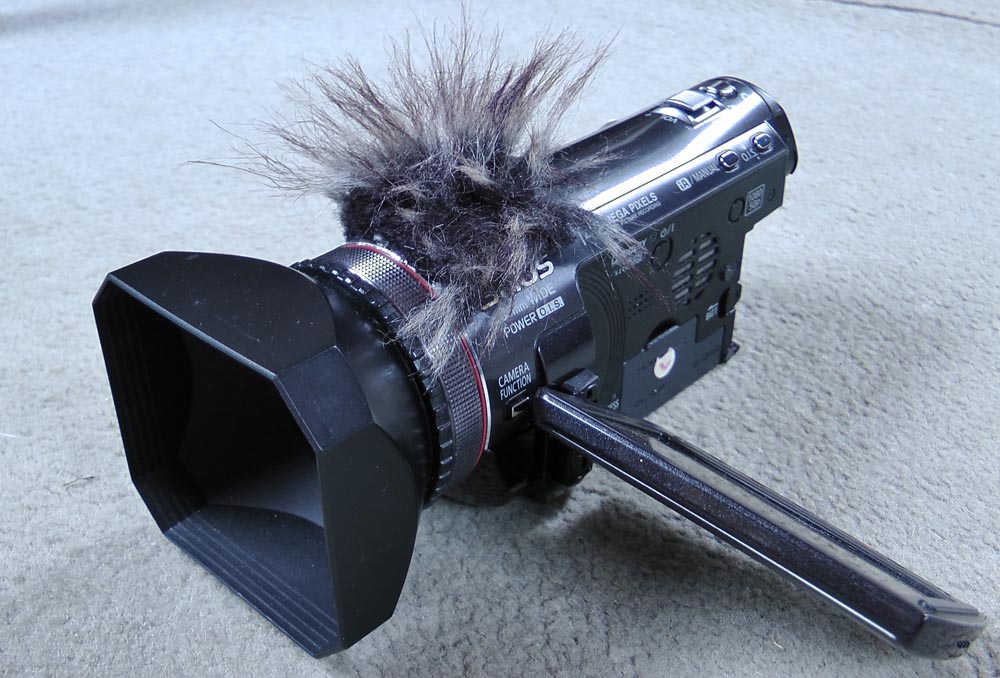

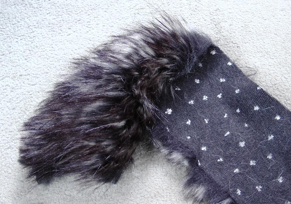

With reference to the onboard mics, I don't have the 920 but I do have two SD700s and an SD750 that have been used continuously for the last 3 years with superb results and the 920 is pretty much the same layout.
The quality of the onboard mics is surprisingly good, but as has been pointed out, are horrendously susceptible to the slightest wind. I film a lot of weddings and want to pick up the ambient sound, so came up with a very effective solution. The dead cat on a hot shoe mounted mic gets in the FOV, but the principle of using a furry material to break up the air movement is what does the wind suppression work. I bought half a square metre of fluffy toy making material from a local haberdashery shop for £2.50. It is a fairly loose weave on the non fluffy side and a quick test recording showed that placing some over the mic grid made little difference to the level and quality of sound capture. A patch about 35mm square is enough to glue over the grid, with a small line of glue around the perimeter.
I fluff the material up for stronger winds and the suppression in wind noise is staggering. I have no problem at all in winds up to the strength that even a Rycote wind guard would start to struggle. It takes less than a minute to cut a piece and glue it on and I would recommend it to everyone to try. I have enough material to keep me going for about 50 years :-)

This heavy duty form of Blu tack called black tack is great for securing all manor of things:
Black Tack 19mm x 1m, high strength adhesive putty for: Amazon.co.uk: Electronics
I use it to fasten lavs onto objects etc. It would also work for Roger's homemade wind guard if you do not want to make a permanent attachment.

I used Pritt stick to attach the fur to two of the cameras, as it is quite easy to remove from the camera body if needed. Having said that, one of my cameras has had the fur in place for two years as it doesn't seem to affect indoor pickup.
Roger
