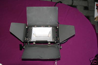

On a flip side, I just copped 2 broad lights 1k W for about $180. did I over pay?
Depends on what they are. So, what are they? Got pics?

Smith Victor 750 Quartz Broad Flood Lights

Here's an image of what one looks like. They're used and was told that they could use either 500w or 1000w bulbs
Hmmm
Smith-Victor | 750SG 1000 Watt Tungsten Broad Light | 401107
