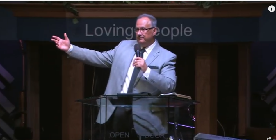

With that many people on stage during the singing section of the service (20:34) it's definitely a Pentecostal church. :-)
You seem to be doing quite well as it is when it comes to footage apart from getting a proper close up shot of the preacher.
Andrew
So do you think this is not close enough? This is traditionally where our camera operator leaves the shot during the sermon. I think they do this because he tends to move around and this makes it easier to follow him, but you are saying we should move it closer? I'm just clarifying

Thanks Owen for your detailed response. I'm looking forward to helping our church move in the right direction and this is exactly the type of response I needed.
As for our services and it's format, there's not too much I can do. They kind of do their own thing. This broadcast is streamed on our facebook page and youtube and often gets shared by our members. It's biggest use is letting people watch who can't be in service that day, have moved or consider themselves part of us but don't actually attend. We have had random people come to us because of these broadcasts, so that is obviously part of it as well. I say all that to say - these services aren't really edited - we do an edited TV show once per week that's 28 minutes and much more condensed. For that, we remove the music and only have the sermon. What I linked to earlier was simply a live stream of our service which we do three times per week.
Great suggestions on the sermon and how the pastor walked in an out of the light and how we could light him better. I mentioned this to him yesterday and he was 100% on board with starting with all new lights and making sure it looks the best it can before we consider new cameras. So in your recommendation, we need some rim light and better stage lights that will evenly light the stage and remove shadows? Currently our stage lights are pretty close to the stage, so perhaps if we move them back a bit, that would help with shadows. Pastor mentioned getting some LED lights, do you think this is OK? Any suggestions on what type of lights we consider getting?
Part of our issue with our shot selection is we have 4 cameras but rarely have camera operators. I run one upstairs and we almost always have someone on the camera straight back, but we rarely have someone on our side cameras. I think eventually we will get to a system where we get new cameras and just run them all remotely, but we aren't there yet unfortunately
