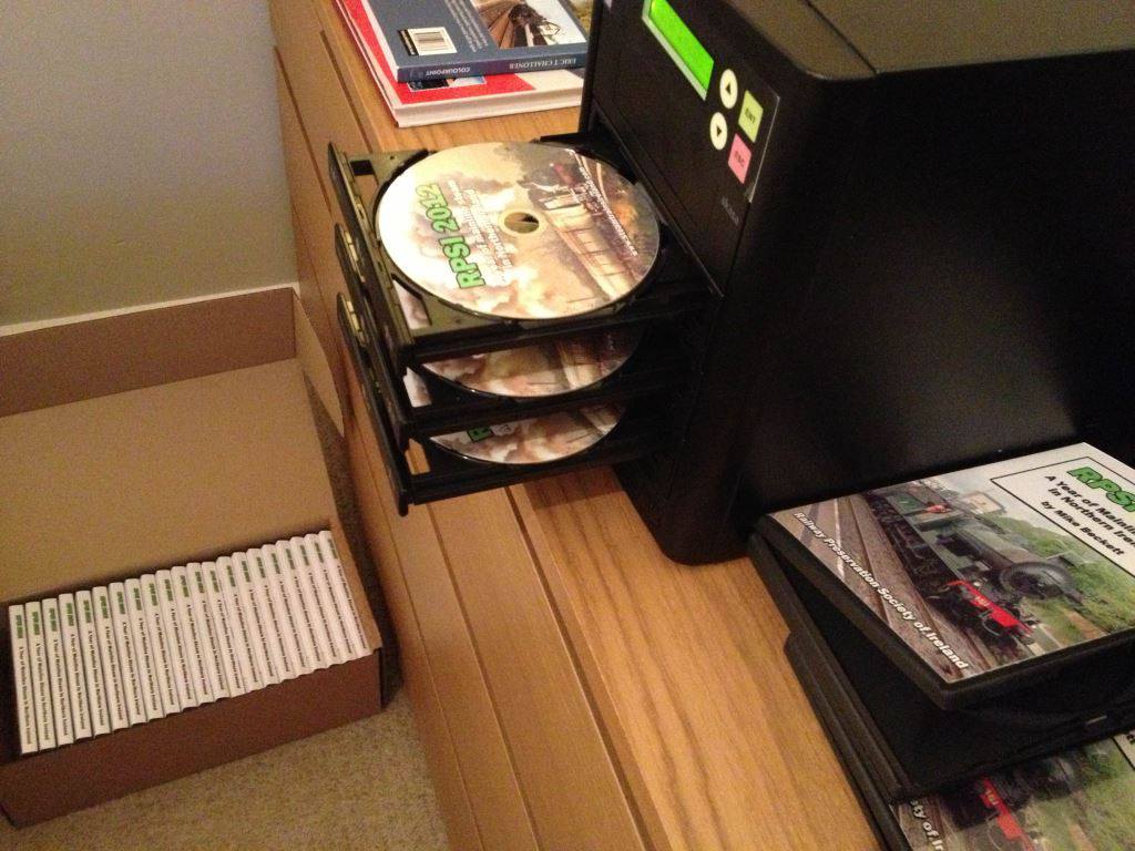

I have a 3-drive version of this (I think it's 4... maybe 3). Other than that, it's the same as you describe.
3 discs? Where's the time saving? Simple, you can do other things while it does the work, your computer is still usable. In hindsight, I would've got more drives - maybe in future I will add another 3. There is also a hard disk for DVD images, which is a huge time saving (rather than ingesting a master each time you burn).
The Lite-on drives did not work for me. Awful. 75% of discs were rejected, yet these were high quality TDK DVD-Rs I'd been buying for years. I tried really, really expensive JVC DVD-R discs, (£45 for 100!) and no difference. Firmware was updated, no idea what the problem was.
In desperation, I replaced all the Lite-on drives with LG drives, and the problem went away. All good now, never a problem.
I am going to rebuild it at some point with 6 drives (I think that's how many ports there are on the Acard board). I read a warning somewhere that the drives should all be identical, one person even said they should ideally be from the same batch. I've no idea how true this is.
For your future proofing, maybe buy 2-3 "spares" at the same time so you can quickly swap them in, just in case you get a failure.
