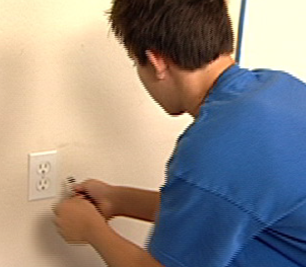

Sorry Marcello, but I STILL think you're doomed to poor results.
The temporal offset takes place <between the fields> NOT <between the frames>
Just do a simple still frame capture from interlaced video content.
See mine attached. SD video frame captured with both fields intact. Then enlarged slightly to make it easier to see edge detail. Click it to full size then look at the kids cheek or hairline.
You'll see that the edges of most objects in motion have a pronounced STAIR STEP appearance.
This is the temporal offset between the two fields.
The even scan started at one position - the odd scan clearly starter later.
Note, this was a shot of a kid taking off an outlet cover before painting a room - and the "motion" is just his natural body movement, not something like a car speeding by!
And temporal resolution is critical to achieving overall higher resolution.
A good example is the classic film of a trotting horse to settle a bet as to whether there was any point where the horse had all four hooves off the ground.
If your temporal resolution is not sufficient to captured enough slices of time to see a moment when all four hooves might be airborn - or at least provide enough motion and vector data to properly interpolate all possible positions of all hoofs - there would be be no way to definitively interpolate that answer.
So no matter how many still shots you take at say - 2 second intervals - unless you get really lucky, you might NEVER see the horse in that position. So you're screwed in the interpolation game.
Another good example happens all the time in security cam footage. The lower the frame rate, the lower the chance you'll get a shot of the criminal's face. And if you don't capture that data, or at least enough to make quality interpolation possible - then all the number crunching in the world won't get you a decent still of the perp.
There's nothing wrong with the idea of trying to up-rez footage. Just as long as you understand the limitations.
The computer can tell you where the passing race car might have generally been positioned between frame 100 and frame 101. But it will NEVER tell you if the driver blinked during at the time of frame 101A. And that means you're NOT increasing temporal resolution no matter how much sophisticated math you bring to bear.

That is exactly what I am saying... The two fields represent two different moments in time.... T1 and T2 that is 1/50th of a second afterwards. What I am saying is that I can pair T1 and T2 but also T2 and T3 and not only T1 and T2 and T3 with T4.

Yes, you can "pair" them. But the result will be a FUZZY frame with poor resolution since you're combining image data with DIFFERENT temporal states. Unless you somehow "line up" the two fields - and if you do that - you're NOT generating new temporal data - just estimating it - or picking one field's state and making the other match.
Either way, you get no additional ACTUAL resolution.
