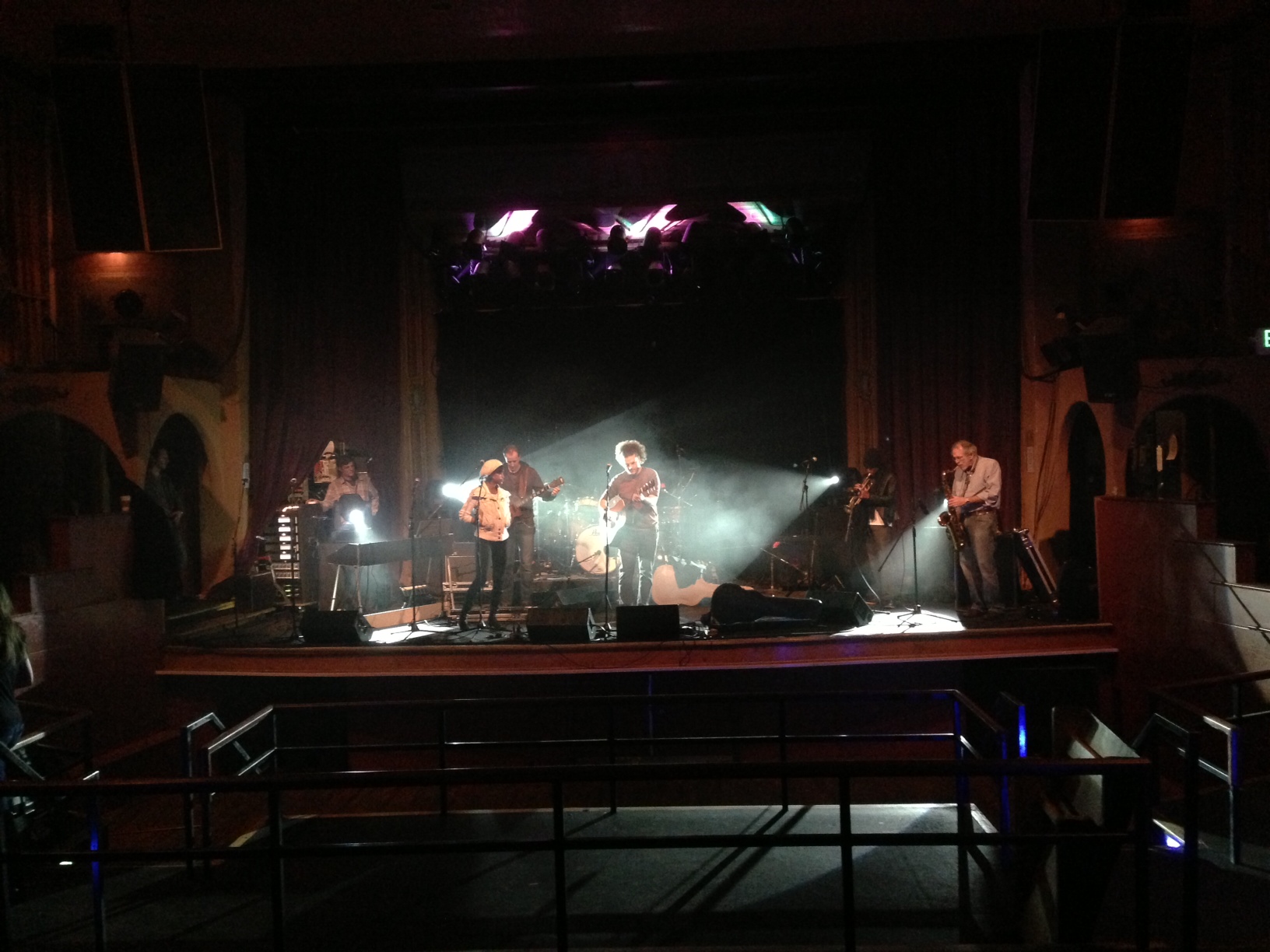

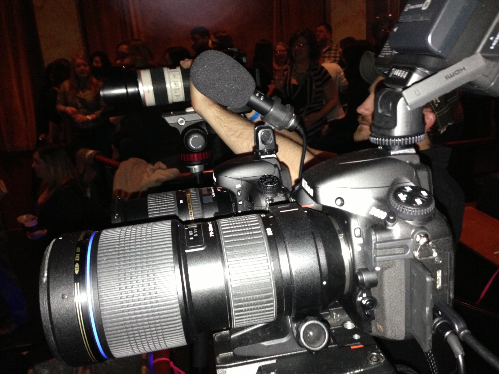

Below are two stills from the sound check and of the cameras. The next few days I'll start editing and I'll follow-up with how things look and act in FCPx.

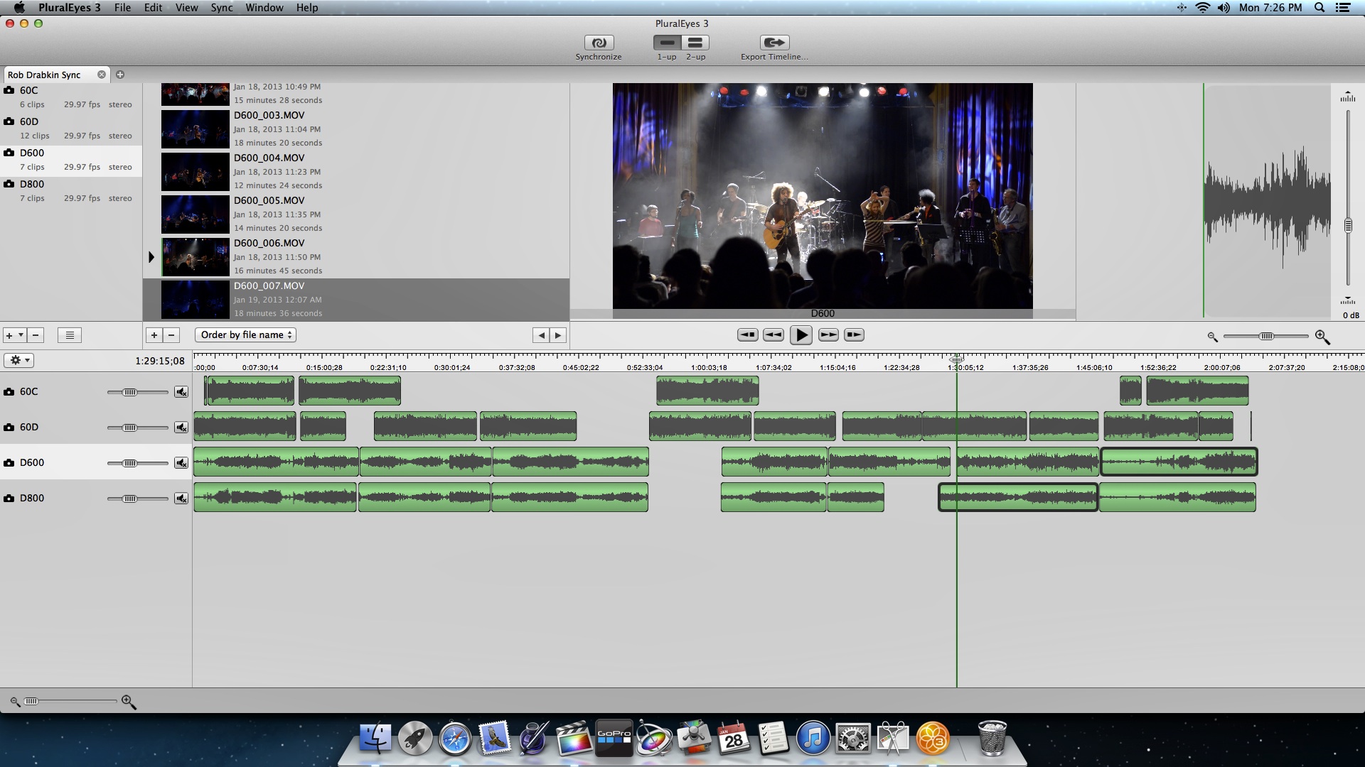

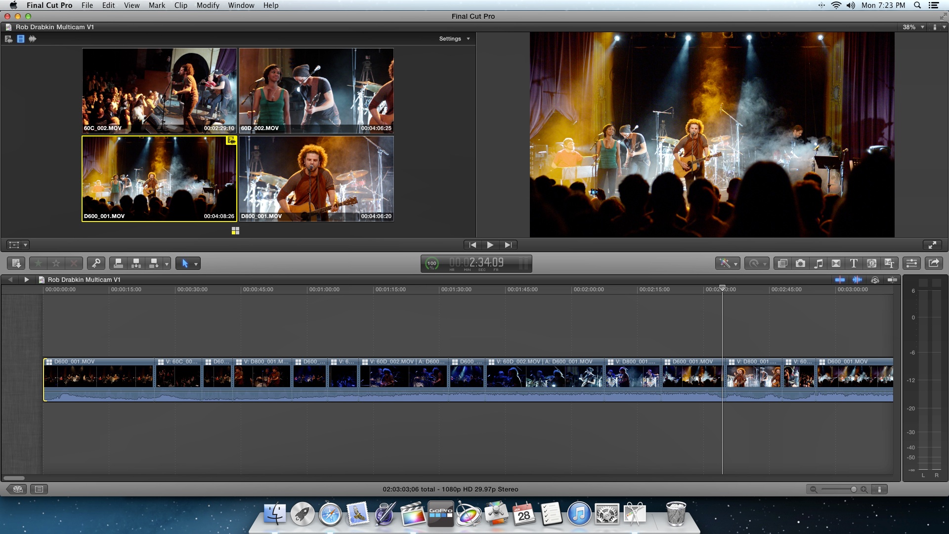

So far, so good. The Nikon footage in FCPx came in seamless. What didn't work seamless was the audio syncing. I knew it was a little more complex than an interview, which up to this point is the only thing that I have synced in FCPx. Multiclip is more complex, especially with DSLR's. So I turned to Pluraleyes 3 which is the latest version.
Having used version 1 and 2 for FCP7. I knew the possibilities but didn't know how it would work with FCPx. Pluraleyes 3 now has its own app for organizing media and syncing. Its very much looks like an editing program in itself. Once organized by camera shots, I then laid all the shots out in there respective timelines.
On the top you just click "Synchronization". The screen started moving clips around and yellows arrows popped up relaying that it was a syncing point and began matching all the clips. It was very fun to watch and happened very fast.
At the end it gave me the choice to export to FCPx, which then launched and created a new event. The only thing remained was to make a new project (timeline) and drop the multiclip in. Open > Multiple Angles via the viewer and your off and running. I'll check back once I'm further along.
FCPX INs and OUTs - Multicam Part ONE (Good reference video for FCPx Multicam)
