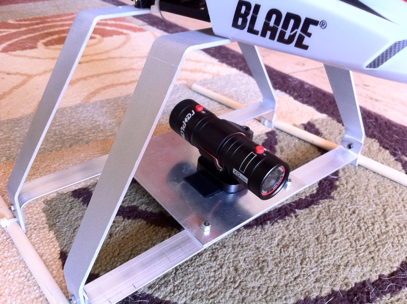

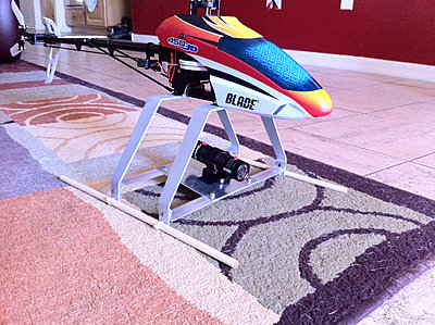

Well, mine is probably overkill but seems to work well, It's 2 sets of small airplane landing gear with some lightweight crossmembers and wood dowels for skids.
I will be tweaking this a bit as the camera plate flexes enough to induce some camera shake. The biggest thing this design allows is easy removal of the camera (1/4-20 camera screw from the bottom. And it also allowed for a slight downward tilt to the camera which looks better when in a hover.
Once I solidify the mount I will be taking some test footage at a local park.
I'll post as soon as that happens. Finally starting to get below 110 deg here!

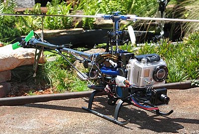

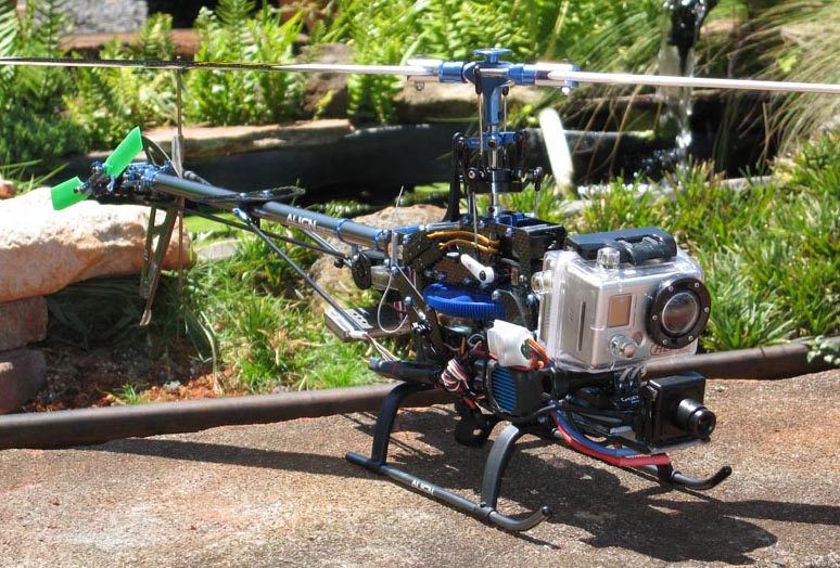

Here's what I HAD set up with the GoPro. Since this photo was taken, it's been stripped down, the GoPro has been removed and things have been moved around.
I'm going to put the Replay in the same location as the GoPro but with a different mount. I might also try to see if I can come up with a way to isolate it from vibrations with a type of adhesive gel strip.
I'm trying to keep the camera as close to the main rotor shaft, and as close to the CG as possible. My theory is that the closer it is to the center, the smaller the amplitude of vibrations imparted to the camera.
The battery goes underneath, and I've extended the skids with tubular foam. It's lightweight and lifts the helicopter 1/2" to provide better battery clearance. It also provides me with a better sense of orientation since there's no canopy.
Below the camera is a real-time "FPV" camera to let me see what the heli sees in real time.

Yours looks cool to. I wanted to keep the camera directly below the main shaft for the CG reasons you mentioned. It required no trimming during hover testing which means it should fly just fine in forward. We'll see!!

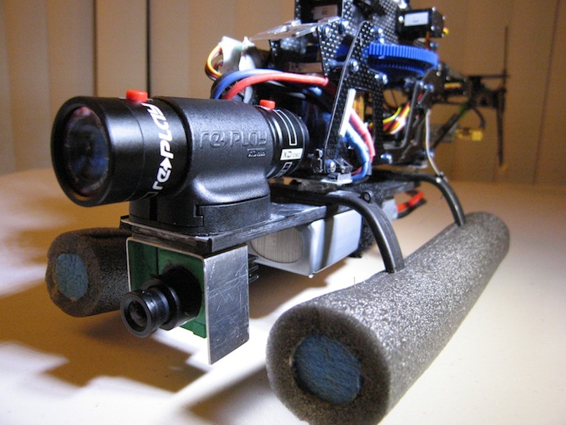

Here's a before-and-after test I did. One is with the Replay 1080XD hard mounted. The other with a vibration isolation setup I cobbled together.
Vibration test, T-Rex 450 and Replay 1080XD - YouTube
After re-doing the mount and centering the camera, here's another test flight.
Test flight, T-Rex 450, Replay 1080XD - YouTube
