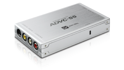

Not sure if you're PC or Mac, but this converter works with either one:
The only catch is that the output is FireWire, which is getting harder to find on computers these days. The older Mac Pro and iMac used to have FireWire but it's been dropped from the new iMac line. I still have an older PC laptop with FireWire and I'll probably keep it for that reason as long as it still boots up.

If your VHS deck doesn't have a TBC (time base corrector) built-in you will also need an external TBC for quality VHS capture when using the ADVC-55.

Sounds like you have things under control. The ADVC-55 outputs standard definition DV over firewire, so if your Mac Pro has a firewire input I woud think it could capture from such a device. Anyway, the specifications indicate the ADVC-55 works with iMovie and Final Cut Pro on Macintosh.

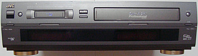

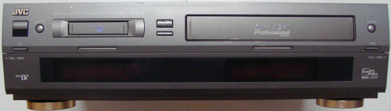

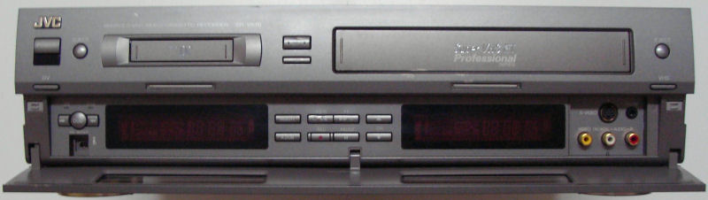

I have one of these. You can buy one like the listing below then sell it when you are done. It has firewire out on the front. TBC built in.
JVC SR VS10U MiniDV s VHS Dual Deck Digital VCR Tape to Transfer Video to DVD | eBay
