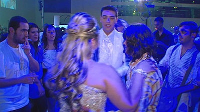

Blue Color Take over the picture
Here is the sample:
what can i do to fix it?
what can i do to prevent it?
many thanks

Here is the pic
Asaf Benatia is offline   Reply With Quote
Old April 26th, 2010, 05:18 AM   #12
Posts: 3,698
Images: 18
Wow..................
Yep, that's impressive.
As I said earlier, I might sleep on it, 'cos it's got me stumped, unless there's a serious problem with either the camera or the encoding.
What, exactly, did this look like in the viewfinder/ LCD when you were shooting it?
The same, or didn't notice?
With that I'm signing off, it may only be 2.14 pm where you are, it's 11. 47 pm ( surely not) here.
Back to the fray tomorrow.
CS

looks the same on the lcd
