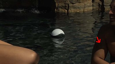

I noticed a white spot (8 Seconds) did you saw it ?
can you tell us your setting? did you have the Canon or Fujonon lense ?

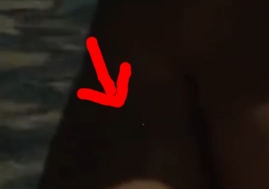

Less details so you got less noise right ?
About the white spot have a look here Lou
Mike

Mike, you may have discovered an issue with our camera. I'll have to look at some other footage and try to determine what's causing that white spot...I don't think it's dust on the lens.

A dead pixel?
It looks like it could be a dead pixel. It happens from time to time on my 700. There is a quick fix in the "engineer" menu. If your dealer thinks thats what it is I can pass along the instructions on how to do that.

Hi Lou I knew I was right ;-)
I used to have one two :-(
but it's easy to fix folow this instrcutions and it would be fixed quicly !!!
.WARM CAMERA FOR 30 MINUTES
.SET CAMERA TO 720 60P
.POWER-UP PLUS PUSH THE DISPLAY BUTTON AT THE SAME TIME WHILE CAMERA IS POWERING.
.PRESS....MENU PLUS FOCUS ASSIST BUTTON AT THE SAME TIME
.ADVANCE MENU WILL APPEAR
.SCROLL TO ADVANCE FUNCTION
.PUSH: SET BUTTON
.SCROLL TO THE WORD: PIXEL COMPENDET
.PUSH: SET TO EXECUTE
.NOW: PHYSICALLY EXECUTE THE PROCESS
.EXECUTING WILL FLASH THEN STOP
NO MORE DEAD PIXEL(S)
