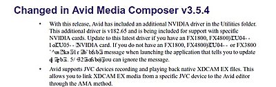

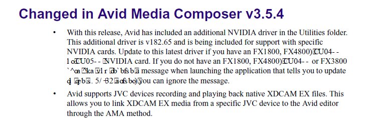

Avid Media Composer 3.5.4
As of now Media Composer supports JVC's which use the Sony codec with the new AMA feature.
Those are very good news for all Avid editors.
