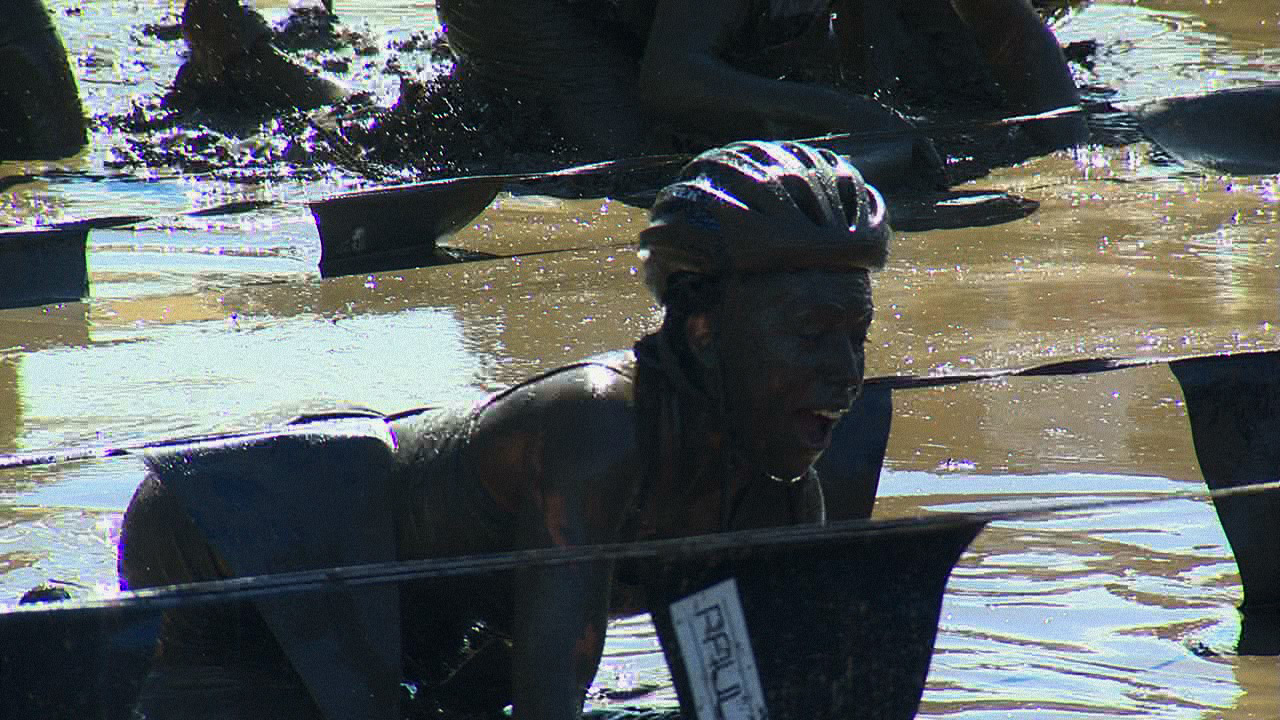

OK so I understand that "CA" stands for Chromatic Aberration. I understand Chromatic Aberration is purple, or green (etc), is annoying as all hell, and makes a lot of people want to aim their credit cards at yet another nine thousand dollar target. I understand that it occurs mostly near the end of the zoom on the stock 16X lens, but that even the nine thousand dollar lenses don't clear you of it completely. I even understand that it especially occurs on edges, between high contrast areas. But I don't understand why, really. Something about bending light like on the Pink Floyd Dark Side of the Moon album cover? (Don't worry, I already know I'm shot).
Please hang with me for one minute more..
I can't quite digest two things lately: One, that a 900 square foot condemned house in Palo Alto sells for 1.5mil in one day - and Two, that I need to spend another ten thousand dollars if I want to zoom in on my girl slopping mud all over herself WITHOUT her having purple teeth (almost) once I get back to the Mac. I know, I know, "Don't zoom"

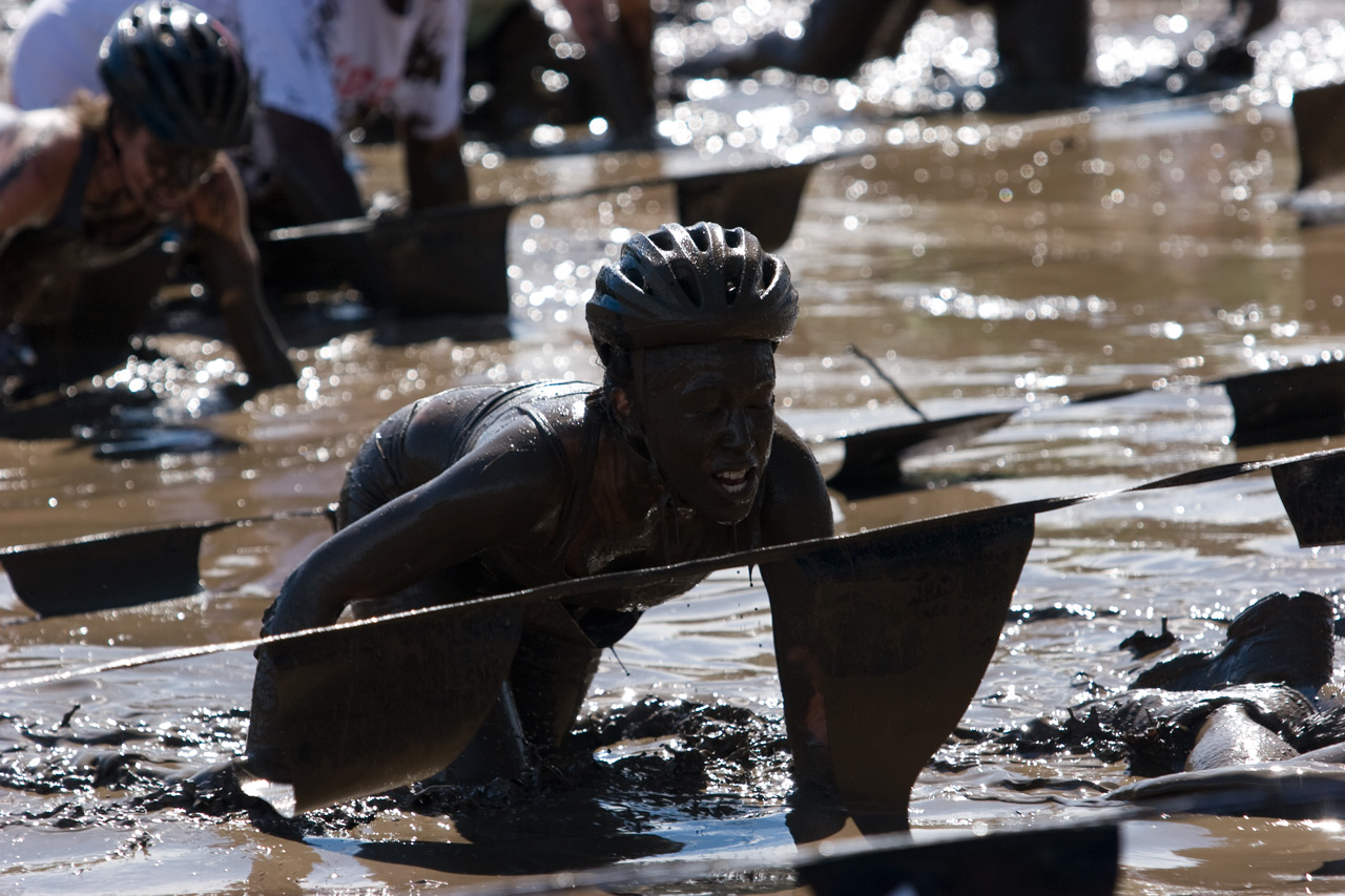

I'd like to ask just why it is that my fifteen year old son can wind up my 70-200mm Canon EOS lens (which sells for around $1,600 new) to 190mm and there's no CA, while I can't do even close to the same with this Fujinon 16x under the same conditions at the same angle, same moment, same subject? We stood elbow to elbow.
Just what is CA? What is happening inside this Fujinon lens/HD200 that is not happening inside the Canon.
Thanks in advance for any help at all.

Chromatic Aberration is where the colors of the spectrum don't all come into focus at the same focal plane. It can be caused by a few different things, with the lens being one piece of the puzzle. Another would be the prism block inside your JVC camera. Three chip cameras have to use a prism to split the colors out onto their respective sensors, red, green, and blue. The reason your son isn't having this problem is because still cameras use only one imaging chip, so there's no need to split the incoming light rays. Video lenses are made to focus while recording an image without excessive breathing. This requires more lens elements and that can contribute to chromatic aberration. Particularly at the near and far ends of the zoom range. Still lenses will breathe when focusing, but it's not a problem because you focus, then shoot a single frame. The lens design is simpler and helps reduce chromatic aberration.

The short answer is that the Canon 70-200 only has to look good over a range from 70-200mm, that's a 2.85X zoom, while the Fuji 16X has to look good over the much larger range from 5.5mm to 88mm. It is much more difficult to design a lens that has to perform at many different focal lengths.
The basic reason CA happens is because different wavelengths of light are bent at different angles when they meet a refractive material. The shape of a lens element and the refractive index of the material it is made from affect the amount that rays of different wavelengths will diverge. CA can therefore be somewhat corrected using several elements of different shapes and materials. However, CA is not the only abberation that lens designers must take into account, and complicating the design of the lens with the need for a high zoom ratio and low cost (as in the stock fuji 16X) can make things very difficult. Any lens is a compromise between hundreds of different factors, the best lenses are so expensive because they compromise less on cost-related factors such as pricy materials for the lens elements. The 70X and above lenses used for sports broadcasting are possible because being tripod mounted they don't have to compromise on size and weight. They can also cost as much as a small house.

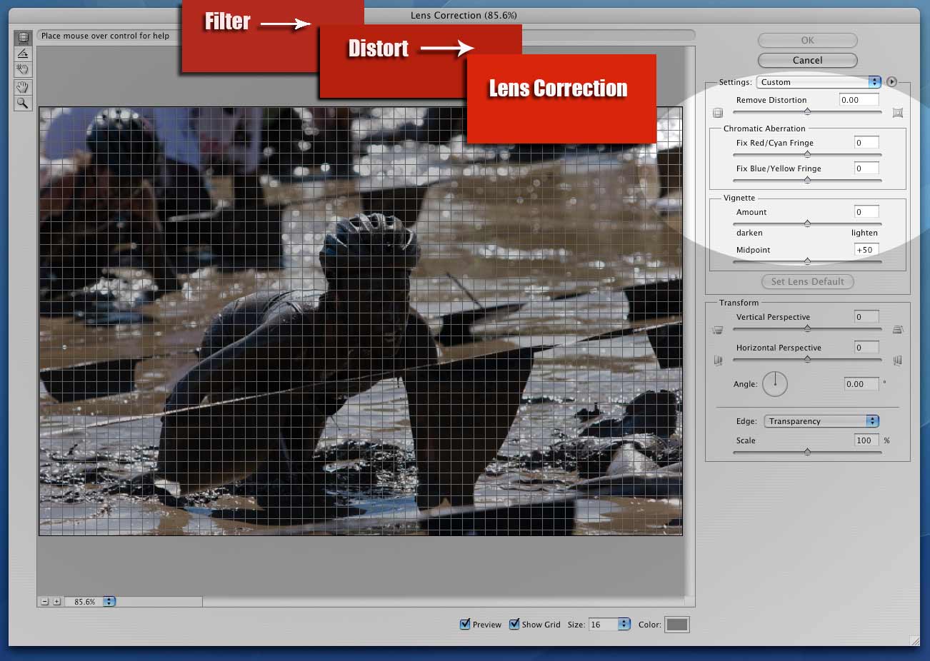

I know it occurs with still photography lenses, so I bet it occurs on film lenses as well (depending on the quality of the lens). In fact I've attached a screen shot of a window in photoshop which is designed specifically to help you get rid of CA. However I don't think it happens so much on fixed lenses in either world. From what I gather from here on DVinfo.net, CA seems to be a trait that comes along like a monkey on the back of most zoom lenses. Like Mark said, all lenses have a "Sweet spot." Fixed lenses must be built at that spot (hopefully). But zoom lenses seem to pass from before it, through it, and then finally to beyond it as the shooter zooms through the mechanical (instead of the "usable") range of the lens.
I'd like to know if there are techniques, settings, filters, or more ideal lighting situations that can help minimize CA for those times where you simply have to zoom way in - like shooting into a mud pit from behind a crowd for instance ; )
