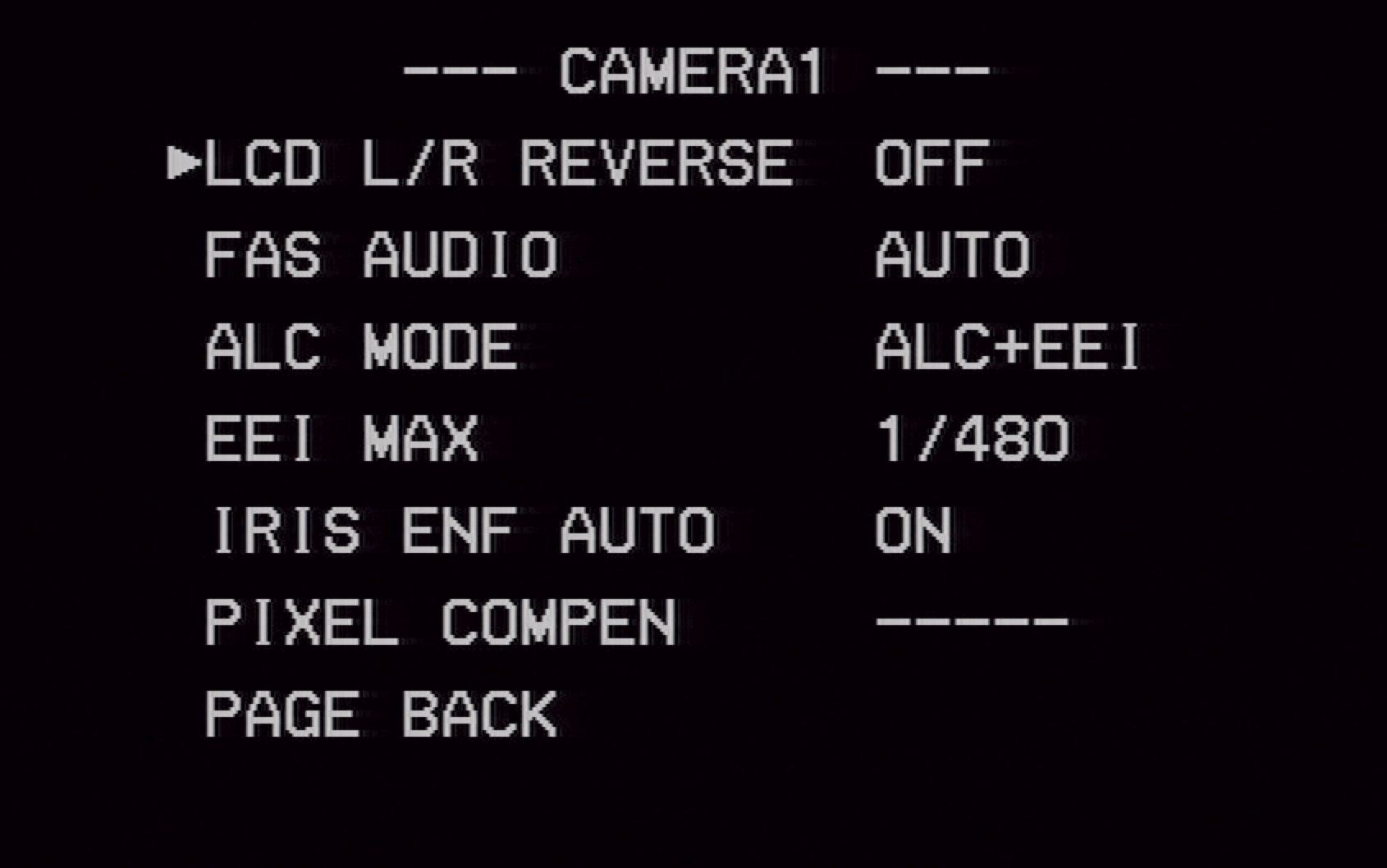

you guys do know that in the menu that shows you the firmware version, there is a LCD flip option - certainly in my 100 its there... no hardware hacks required

were you in the special menu that shows you the firmware rev and pixel remap ? its in the LCD menu

here is a a screen shot of image flip on the LCD L/R on my HD100... your 110 maybe well be different
LCD/VF Image flip on HD110/111?-hd100flip.jpg

Press focus assist and menu at the same time.Hold down for 2 seconds.

lcd l/r reverse is not available in my hd110.

I just checked my GY-HD110 and this option LCD L/R reverse is not available in my camera too.
Is anybody who checked this option on GY-HD100 and can tell us if there is an upside-down inversion, or is just a left/right inversion (mirroring), like that in the GY-HD110, because this is one of the new changes in GY-HD110 vs. GY-HD100?
I have this feeling, that in GY-HD100 and GY-HD110 is not posible to see in VF or LCD the right image with HZ-CAU13. The only solution is to rotate manually the LCD of the viewfinder.
It is just my opinion.
