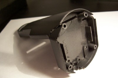

Not exactly. It doesn't take much to crack the viewfinder. Day to day operation will crack it, but it doesn't prevent the electronics from working.
Attached is the actual part that cracks very easily and if you take a look at the way it's engineered you can see why. There is no reinforcement.
S.Noe

I can't see this particular photograph offered by Stephen due to a frustrating situation I finally emailed Chris about, where half of the time when I'm asked to log in to be able to view a photo link or footage link, it just bounces me back into the blank log in fields. Though I'm actually logged in at that point.
But, I'm guessing the picture was of the thin plastic support that slides in and out for viewing comfort, which is supporting the eyepiece? It doesn't seem very sturdy. And in fact when I returned the camera today they took the viewfinder into the back room and played with it a little bit because they noticed the eyepiece had tweaked into a slight separation at that 90 degree junction. When he pushed it back more tightly together it started working again, but will still need to be sent back for lasting repair. Certainly nothing I did.
