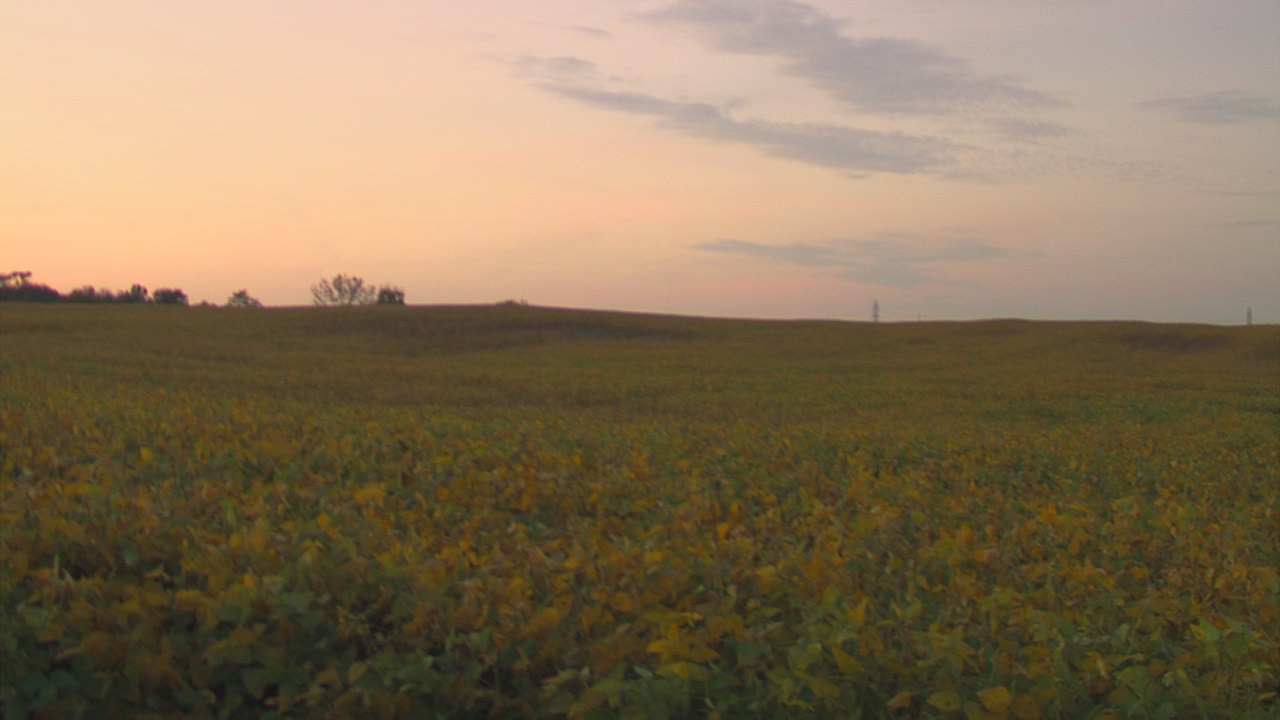

This is at full wide, open, shutter 1/60, 30p, panamatch(i think), focused infinity.
Is this the best the lens gets with that distance? This was on a tripod so..
Also, I've noticed quite a bit of magenta and green edging, is this normal?

That does look a bit soft to me. How did you set up the focus on the shot? Did you zoom it in, focus, and then zoom back out? If so, yes, you probably need to check your back focus.
If you set your focus wide like that, well, you might be in for the same learning experience I had. :P HD is not as tolerant of minor focus errors as DV is. Might just take some practice. Maybe play around with your focus assist and peaking?
I know the stock lens, while not perfect, is capable of producing some pretty crisp images.
As for your magenta and green edging, it's called Chromatic Aberration. (Is that spelled right? Doesn't look like it. Anyways...) It's normal. Every lens has it, to some degree. Cheaper lenses, like the stock lens on the HD100, are more likely to exhibit some CA at full zoom, than, say, the $12,000 (MSRP) 13x lens. There are ways to avoid it. The easiest is to avoid using full zoom. I usually try to keep my zoom below 80%, although I've never had CA problems, even at full zoom.

As far as my experience with this lens goes, focus at infinity, really means very very far away...not 30 or 40 or 50 feet. My guess is that your shot would've looked good if you'd turned the focus ring a tiny bit to the right.
Of course...if you zoomed in,focus and then zoomed out, and it looks like this... that's a back focus adjustement you need to do.

Yes, HD is more difficult to focus, but I think this might be a back focus issue. The distance should of been okay for infinity. Of course I could be wrong, but first double check your back focus to elliminate it as a problem.

Matt, by the way, based on how you set your shot, it appears that back focus was off on your camera.
